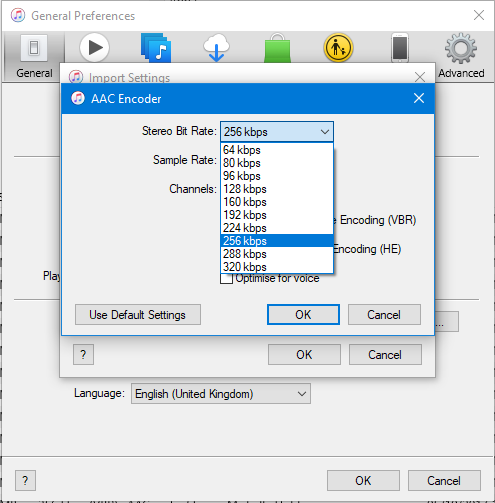

You may need to use iTunes for that. Most AAC encoders only go up to 320 kbps. I’ve not checked (I don’t use iTunes), but I’m guessing that iTunes will support higher bit rates.
Alternatively, it may be worth considering FLAC format. The file size is likely to be similar and it is a lossless format.
It doesn’t
UPDATE: Oops I see that is the iTunes AAC encoder - but their MP3 encoder also maxes out at 320kbps
