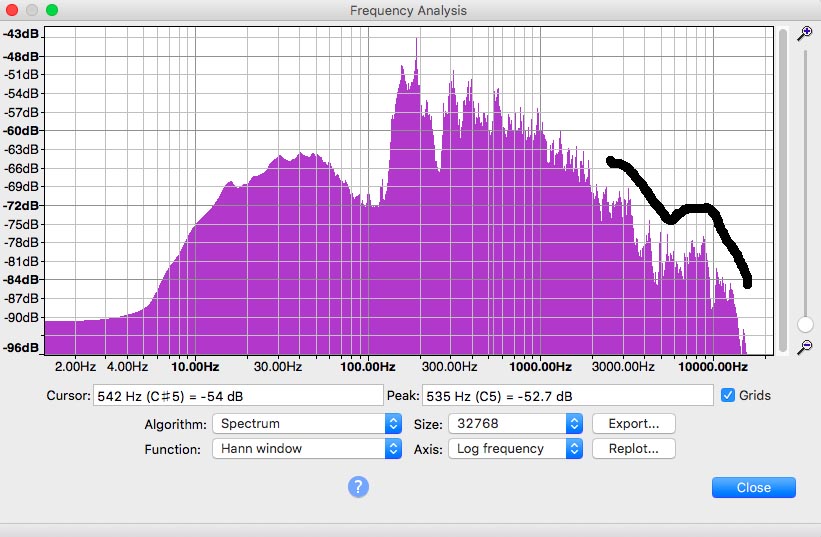

Are you using stiff noise reduction? Sometimes that can sound like it’s boosting crisp sounds and making lip tick sounds worse.
Many home microphones have a crisp boost because that sounds more “professional.” It’s actually visible on some sound tests—a little haystack bump.
That’s not normal on better quality microphones, and among other things, that can give you boosted spit sounds.
