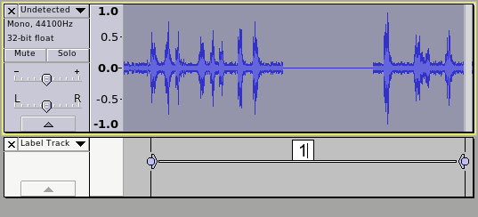

Hello Steve,
I’m sorry to be a damned nuisance but could I ask you to have a look at this little file and see if you have any idea at all why Sound Finder can’t pick the sounds up please? Just two events from today separated with a few seconds silence.
http://www.sendspace.com/file/u1wz61
Kind regards,
Oliver
I followed the recipe:
