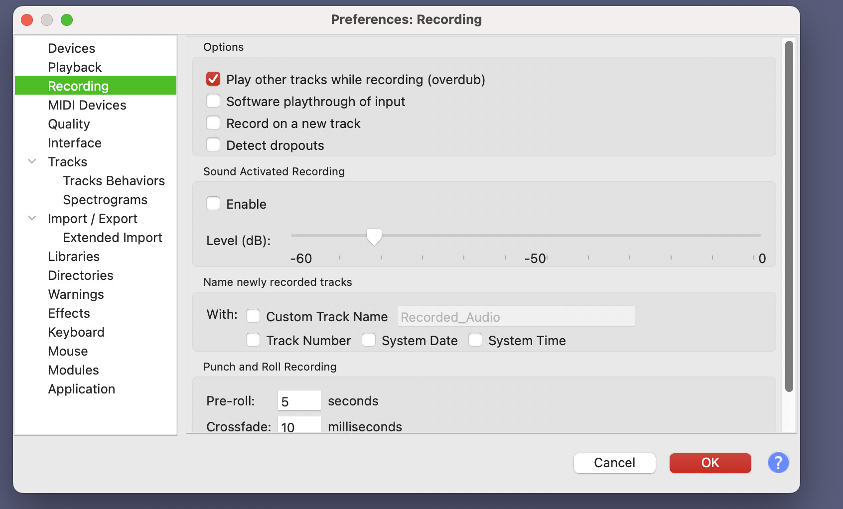

I believe the Yeti will naturally mix your live voice with the sound from Audacity and send the mix to your Yeti headphone connection. This is the configuration for overdubbing and sound-on-sound performances.
If you have Audacity > Preferences > Recording > [X] Playthrough checked, Audacity will send the live performance sound back to the Yeti “one computer late.”
Further, I believe the description of the problem isn’t quite right. It’s not that the headphone sound has a delay. It’s that there are two sounds, one delayed and one not.
De-select Playthrough.

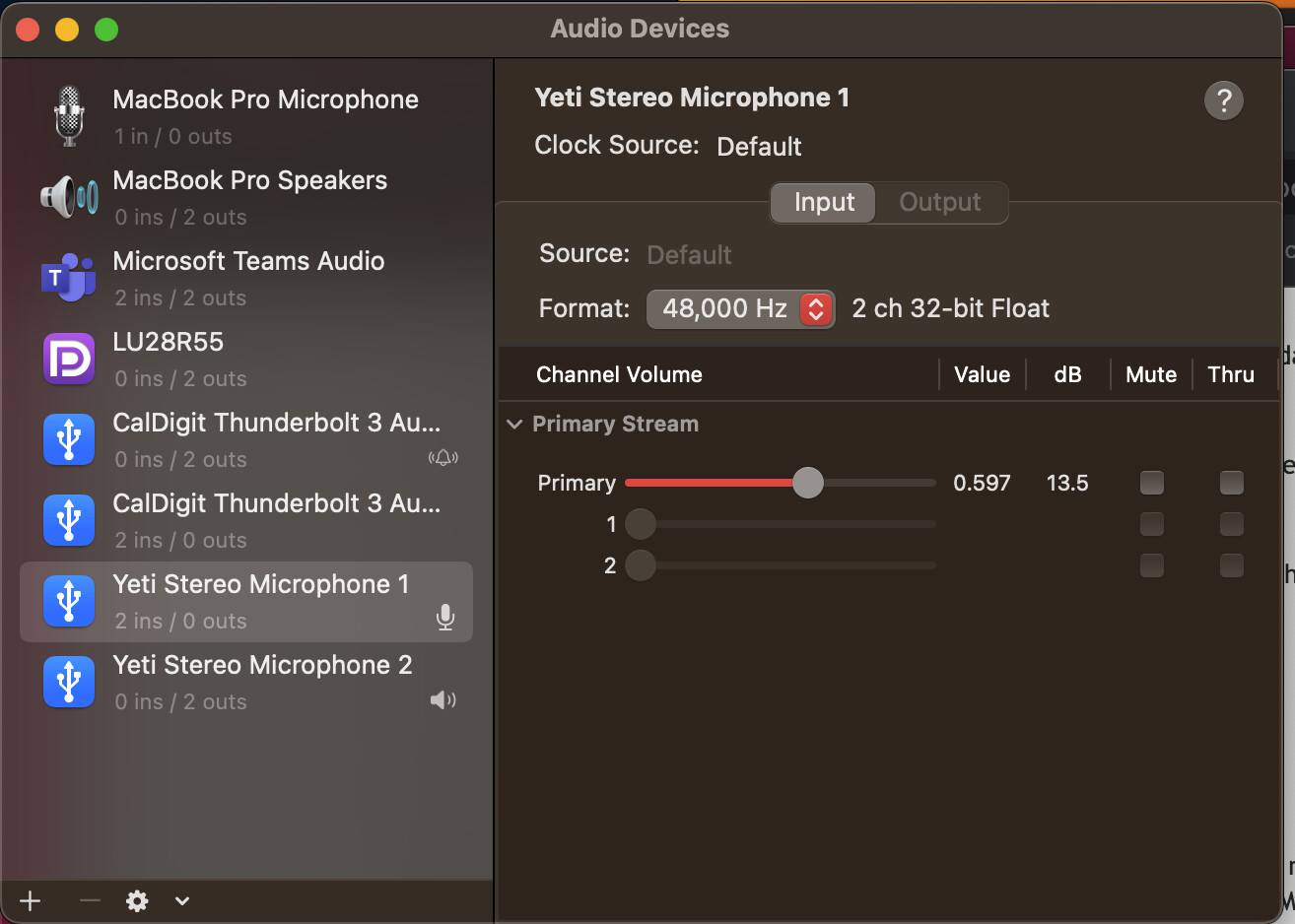

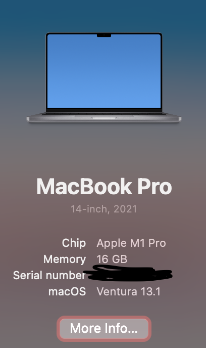

Thanks for the response. I unchecked the Playthrough but now I don’t hear myself while monitoring. See some screenshots with my settings. Maybe there’s something not setup properly.
