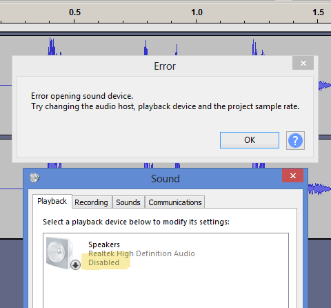

I’ve downloaded and added the De-Esser plug-in to Audacity and it is now one of the effects I can use.
Problem: When I use it, it causes Audacity to become unresponsive and shuts down on its own or when I try to listen to the adjustment - this error shows up and I have to manually close down the program. :frowning:
If someone can help me fix this or provide me with an alternative - that would be much appreciated. :slight_smile:

That error is not caused by installing/using a plugin.
Changing the input or output devices, (mic or speakers), can cause it.
Try reverting the microphone set-up to what it was.
I did what you told me and the same error pops up when I playback the track. Thanks for trying to help though.
Selecting a disabled playback device will generate that error when you attempt to play Audacity …
If the playback device is enabled, try changing the audio host, (there are only 3 options).
I lessened everything on the default settings of the De-Esser and it worked out!! :smiley:
