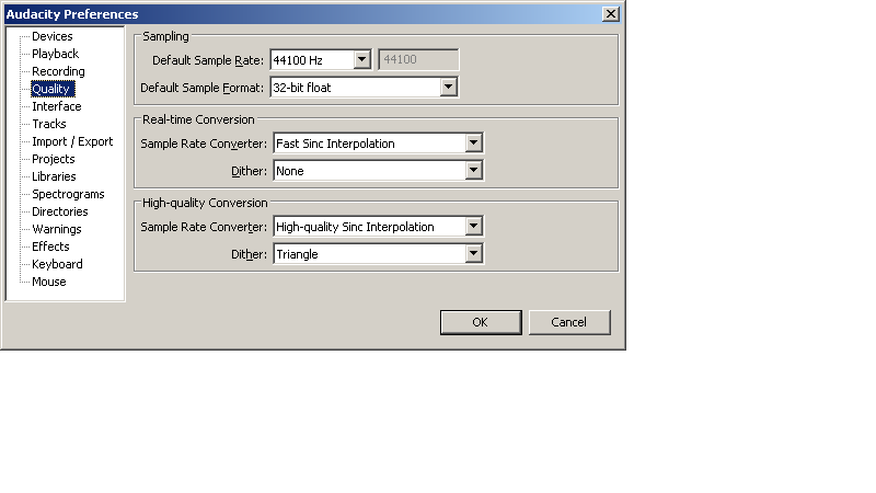

these are my Quality settings:
With regards to the Dither settings, have a read of this article in the Wiki: http://wiki.audacityteam.org/wiki/Dither
WC
“High Quality Sync Interpolation” and “Triangle dither” (or “shaped dither”) are good for the “High Quality Conversion” settings, but if used for the “Real Time Conversion” settings will tend to make the computer sluggish and reduce Audacity’s performance. The “Fast” and “No dither” settings (as per waxcylinders screenshot) are perfectly adequate for Real Time Conversion and have no effect on the actual recording or the finished product.
