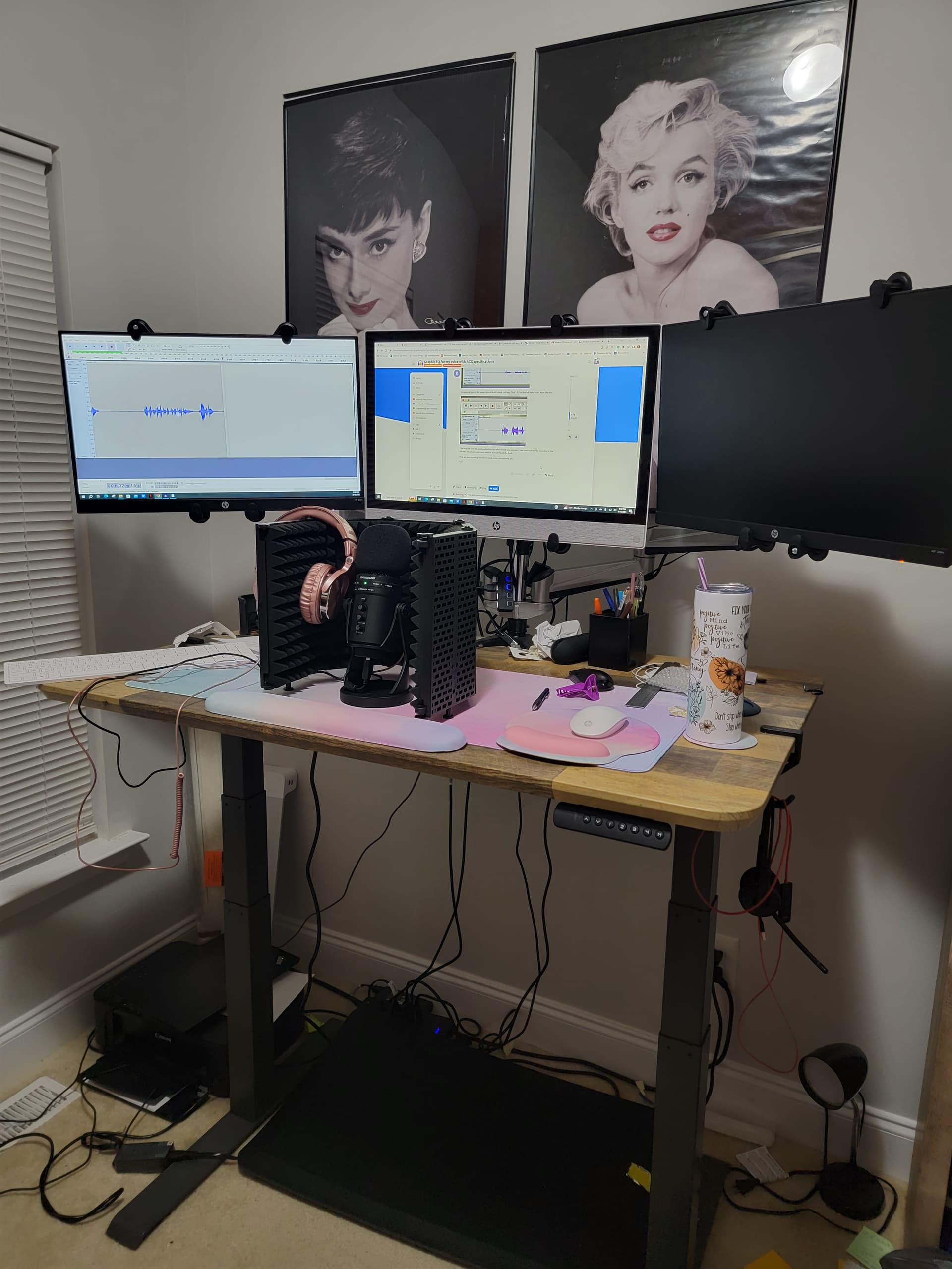

How are you recording? Details on desk, room, microphone, etc.
5x8 office with closed doors

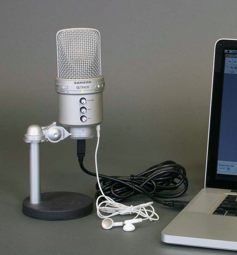

I love G-Tracks. I shot some of my show illustrations with a borrowed G-Track.
I told the owner that if he wasn’t watching really close I was going to go home with it.

I need to pick this up tomorrow morning (California time). Your microphone is fancier than the one I had and I need to rip through the instructions a bit—best done with Starbucks®.
I will tell you right now I would put a bit more soundproofing in. Fold over a heavy bath towel and lay it on the desk. Put the sound walls and microphone on that.
See what you can do with the top. It should not be open like that. The problem is you can’t put anything hard up there.
You have the tiny, efficient version of my Kitchen Table Sound Studio.

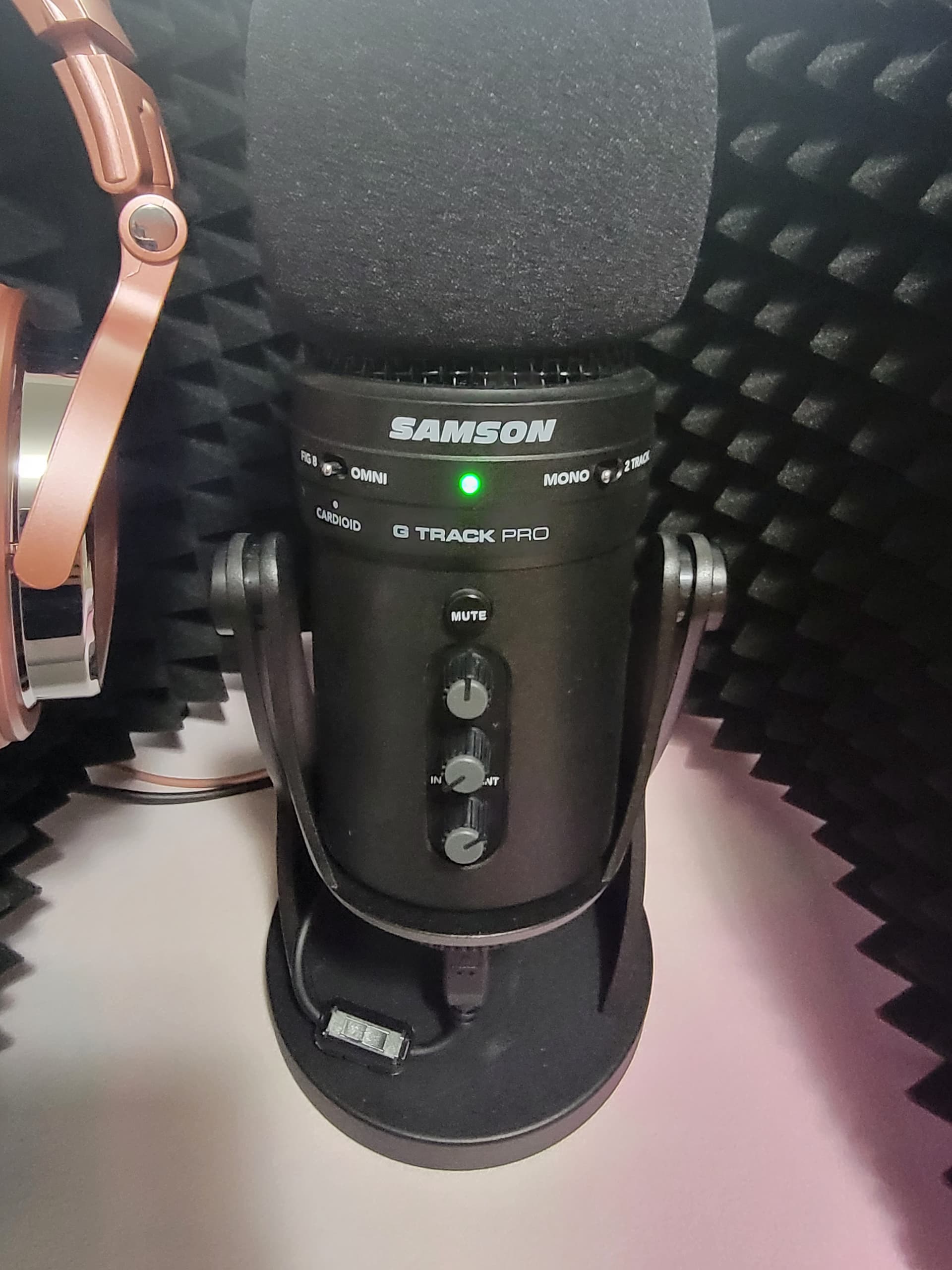

The microphone pattern selector on the left should be in the mid position, Cardioid. You should be speaking into the side grill of the microphone just up from the company name.

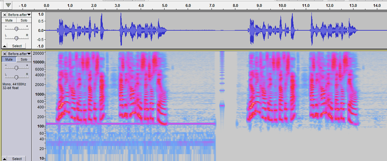

There is a noticeable 120Hz constant tone (mains hum).
It can be removed with a notch filter,
but it causes some collateral damage to speech.
before-after 120Hz notch q=5
A Koz mentioned you still have noticeable room reverb.
[ There is a refection after a ~6 millisecond delay => a round-trip of ~2m,
so the reflecting surface (wall/ceiling) is ~1m from the mic ].

Forget Audacity for a minute. Turn the INSTRUMENT knob all the way down and the MIC knob all the way up. Turn VOLUME (headphones) down temporarily. Speak normally as a test. Do you get the little light under the company name turning red? If not, speak louder and get closer until you get red flashes. Speak quieter until the red flashes go away. That can be about normal performing volume.
I didn’t make this up. This is from the instruction book.
Post back how this went.
We need responses from the other notes. Are you speaking into the side grill just up from the company name and is the little switch on the left on CARDIOID?

As Koz said, putting a top/lid on the box around your mic would be the first thing to try to shield it from reflections.
A book mummified with a hand towel may suffice as a lid.
got a top
These foam lined boxes are a big improvement over a bare room with no acoustic treatment, but they are not as good as an actual sound-booth.
The red light is a handy indicator to help you use the microphone properly. It will not break anything to have it flash.
