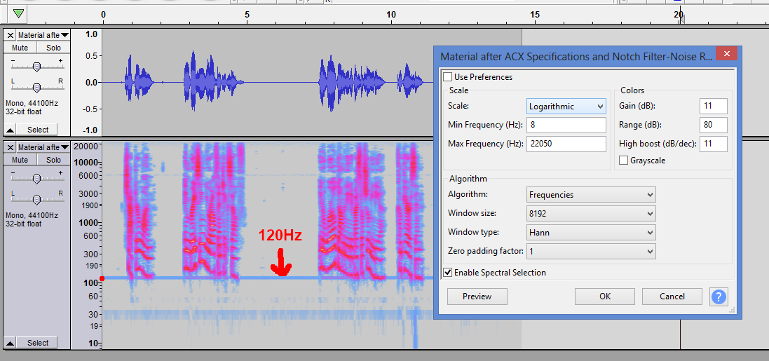

The 120Hz tone is still there …
Multi-view - Audacity Manual .

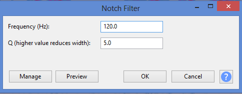

Notch filter
Notch Filter - Audacity Manual .

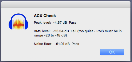

ACX-Check_2023-08-16
Also, Noise Floor seems to pass but is still too loud. It is strongly recommended maintaining at least -65dB. This could be a reaction to that 120Hz wall power hum background sound Trebor’s been struggling with.
…and that can be a reaction to having your voice too quiet. See: adjust for flashing red light. You can’t skip steps. Everything is hooked to everything else.
120Hz is a noise generated by flourescent lights and regular lights on dimmers. Do you have any of those?

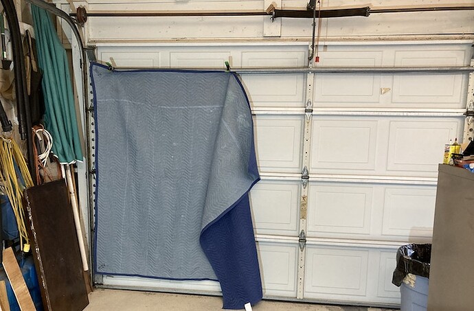

I did an experiment to prove the ancient advice that you could always record in your garage. It worked. All the boxes and trash in my garage made terrific soundproofing and all I had to do was wait until street traffic died out—except one thing. I had to cover up the metal garage doors. I could hear them in the voice.
This is one of two furniture moving pads in partial install.
Maybe you can cover up the glass doors.
