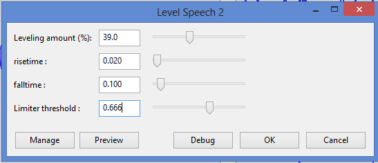

Try the LevelSpeech2.ny plugin …

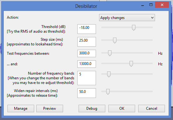

Followed by the desibilator.ny plugin …
