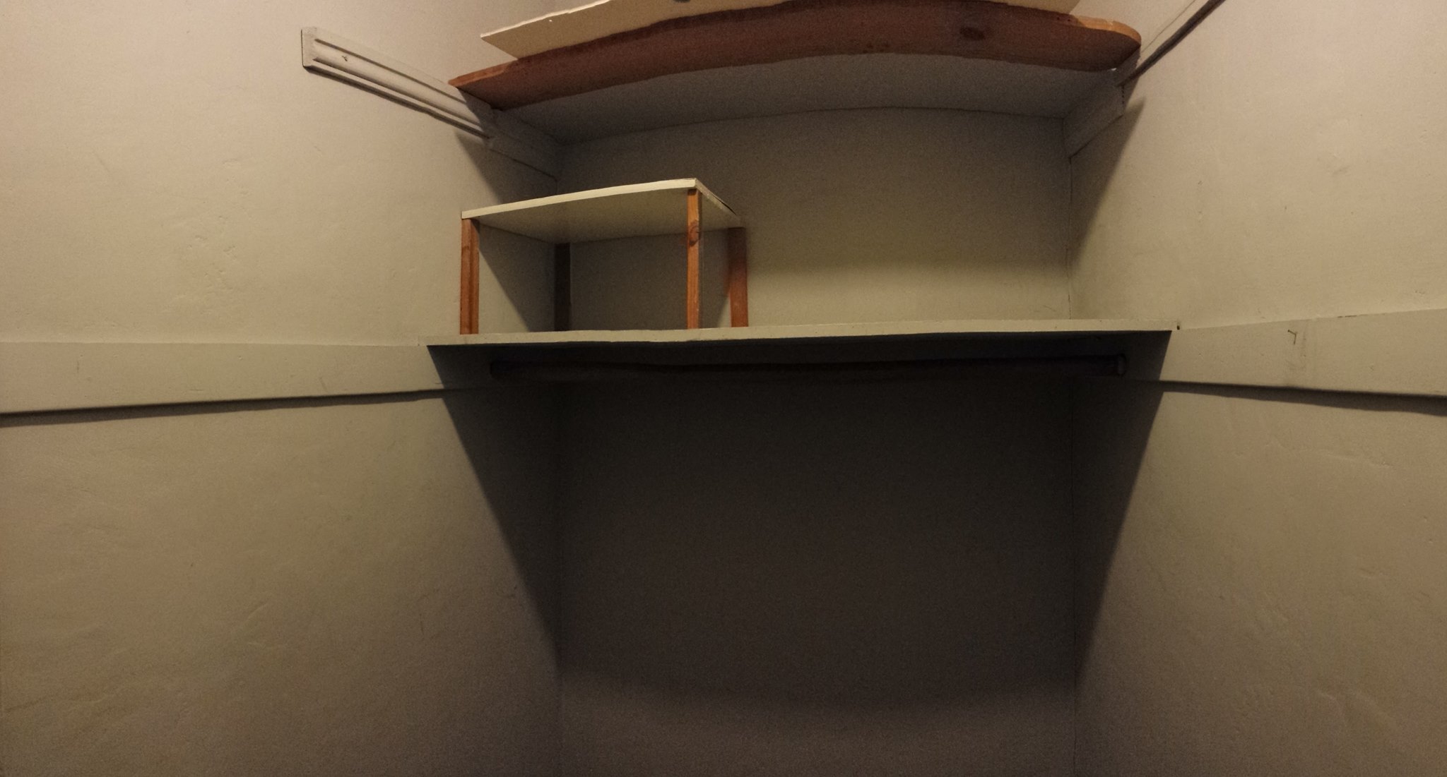

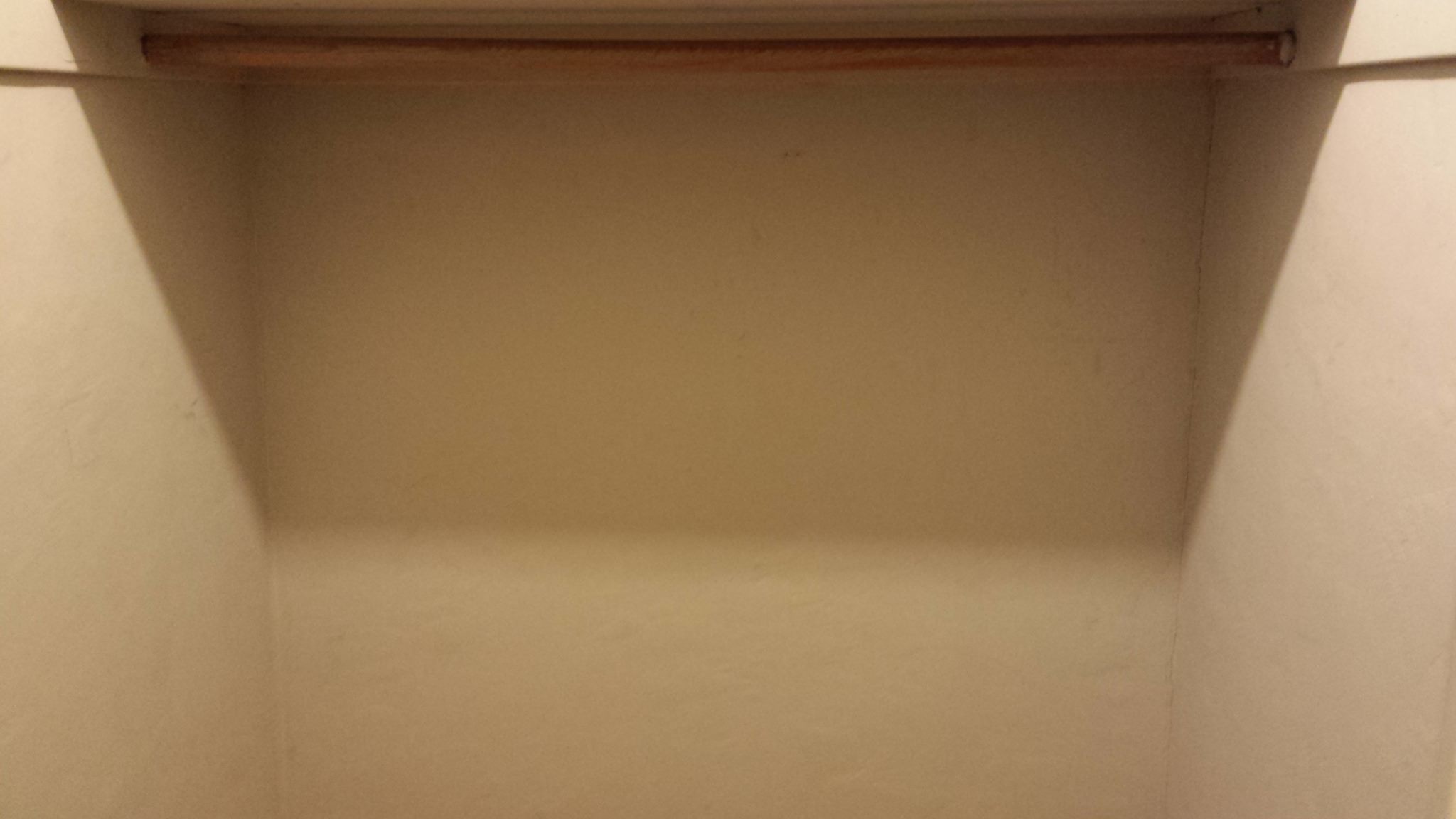

Now completely empty! :slight_smile:
https://www.facebook.com/ian.m.walker/media_set?set=a.10152406596961411.1073741859.641111410&type=3
I decided to remove the clothing after all, Koz. For one, I want a proper read for Auralex and for two, I think it really diminishes the professional look I need to go for. :slight_smile:
I finally measured the room and it is 5’ 3" x 5’ 1", BTW.
Cheers.

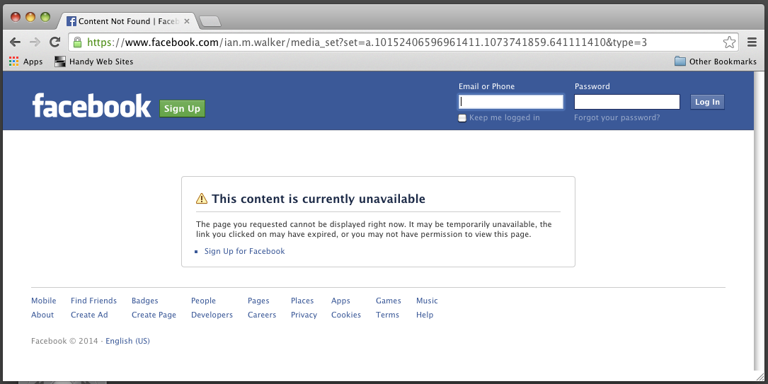

I don’t understand, either. I can see your earlier pictures just fine. Koz

As for FB that is very odd. It has happened to ME a few times but then I go to my profile and hit the album and there it is. I’ve not heard anybody else saying it happens to them, though. I can upload the empty shots here if I’m not burdening you or the system.

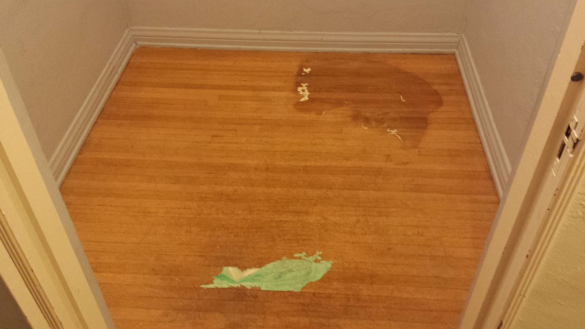

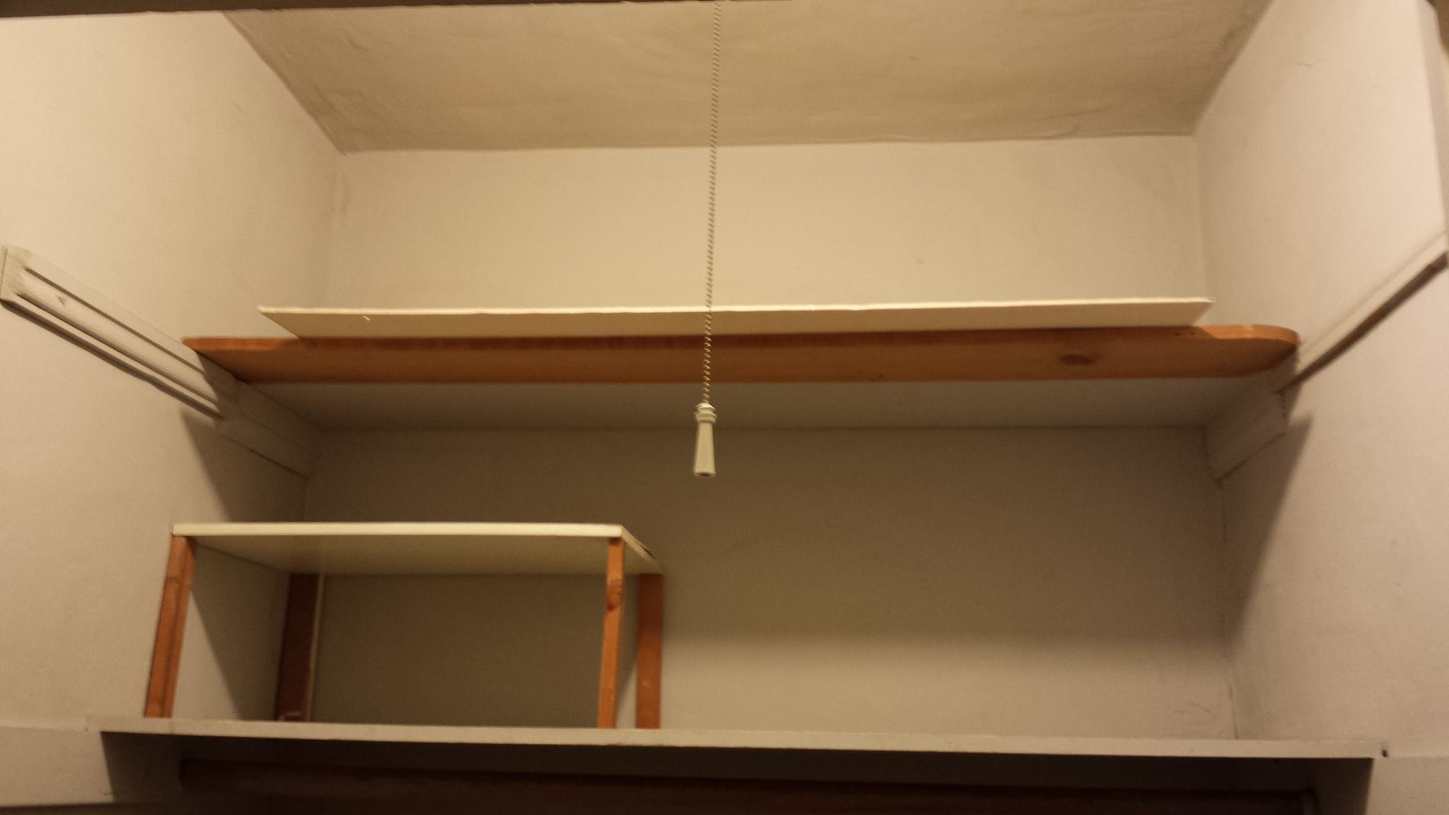

The final “before” shots. :slight_smile:

The first thing that I’d do with that space is to get some carpet down, preferably with old fashioned “felt” underlay below it. If you can’t get the old “felt” stuff, then aim for a fairly dense underlay rather than just the soft foam stuff. It does not have to be a fitted carpet, a rug will do. Carpet can make a huge difference to the acoustics of a room, absorbing much of the “zing”. Given the cost of sound absorbent foam, carpet can work out to be quite economical as part of the acoustic treatment.
Working out exactly what you need is very difficult. Even the experts can make expensive mistakes.
Foam does little to help with boominess, or with sound proofing. What it does help with is “high frequency absorption”, or as I would describe, reducing the “zing” (that bright reverberation that is typified by tiled bathrooms). Generally heavier, more dense foams can absorb down to lower frequencies than lighter foams. For low frequencies (boom), foams are largely ineffective, and that is where various types of “bass trap” come in.
Rooms that have a very regular shape tend to have a less even acoustic response than irregular shaped rooms. Large parallel surfaces tend to accentuate frequencies that have a wavelength that is the same. or an exact multiple of the distance between those surfaces, “Diffusers” can help to break up these resonances to create a more even acoustic response.
One way to judge the “sound” of a space is to stand in the middle, clap, and listen to the sound. How much does it ring? Does it have a discernible “note”. Unless the room is very large there is not likely to be any distinct “echo”.
Particularly because of the expense involved, it is worth doing a lot of reading on the subject before finalising your purchase. There’s quite a good article here: http://www.soundonsound.com/sos/dec09/articles/beginnersacoustics.htm

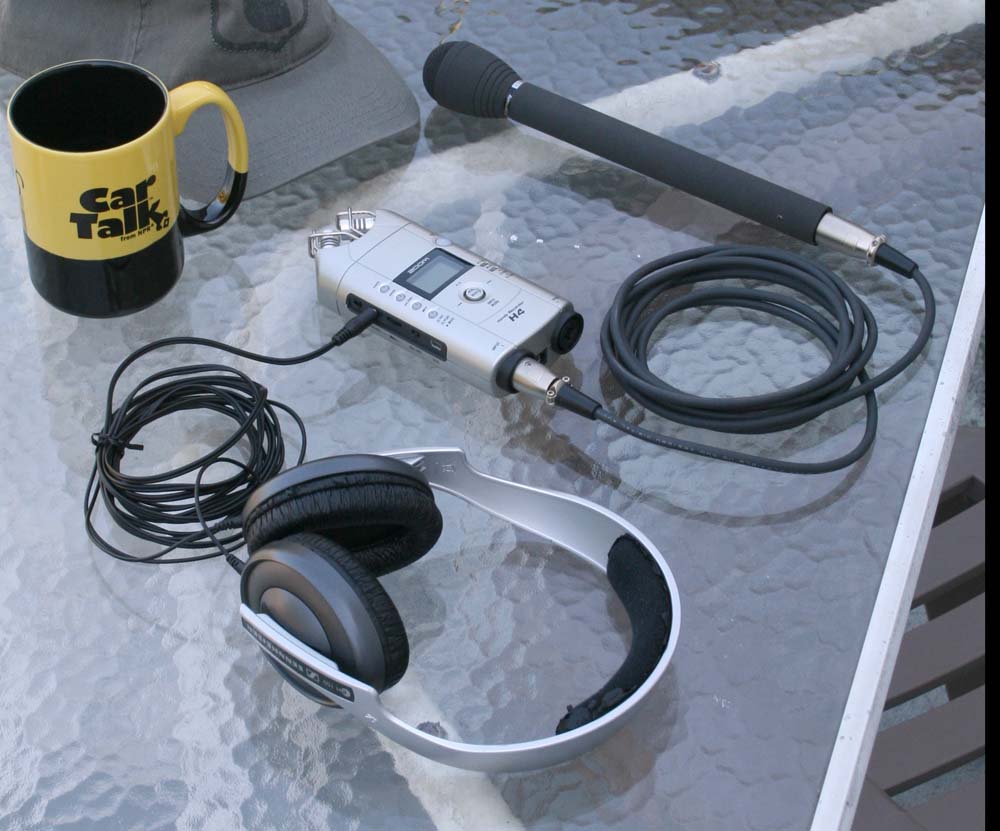

Rode NT1-A
That’s not too shabby. That gets you into the Phantom-Powered XLR microphone territory. That means you can put the microphone a hundred feet away from the Audiobox and the computer. you could put the computer in the car if you wanted.
But… I can’t go to bed until I’ve thrown a little cold water around. The sound meter you have to pay attention to during recording is on the computer and the Audiobox doesn’t have sound meters.
I thought this up for field recording, but it would work for you, too.
That’s a Zoom H4. I think the current model is H4a. You plug your Rode NT1 into that, switch on the Phantom Power, put on the headphones and press Record. The Zoom H4 makes no noise and produces a very nice recording — extended if you upgrade the operating system and buy a larger memory card. And yes, it does have sound meters on the little display, but it doesn’t have good volume controls, so you change volume in gross jumps (H/M/L) and from there with vocal expression or distance.
