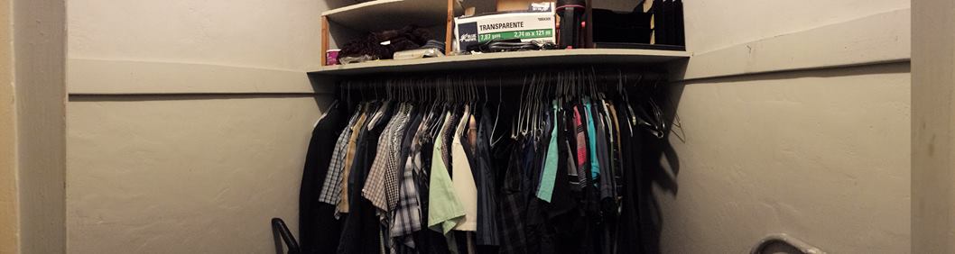

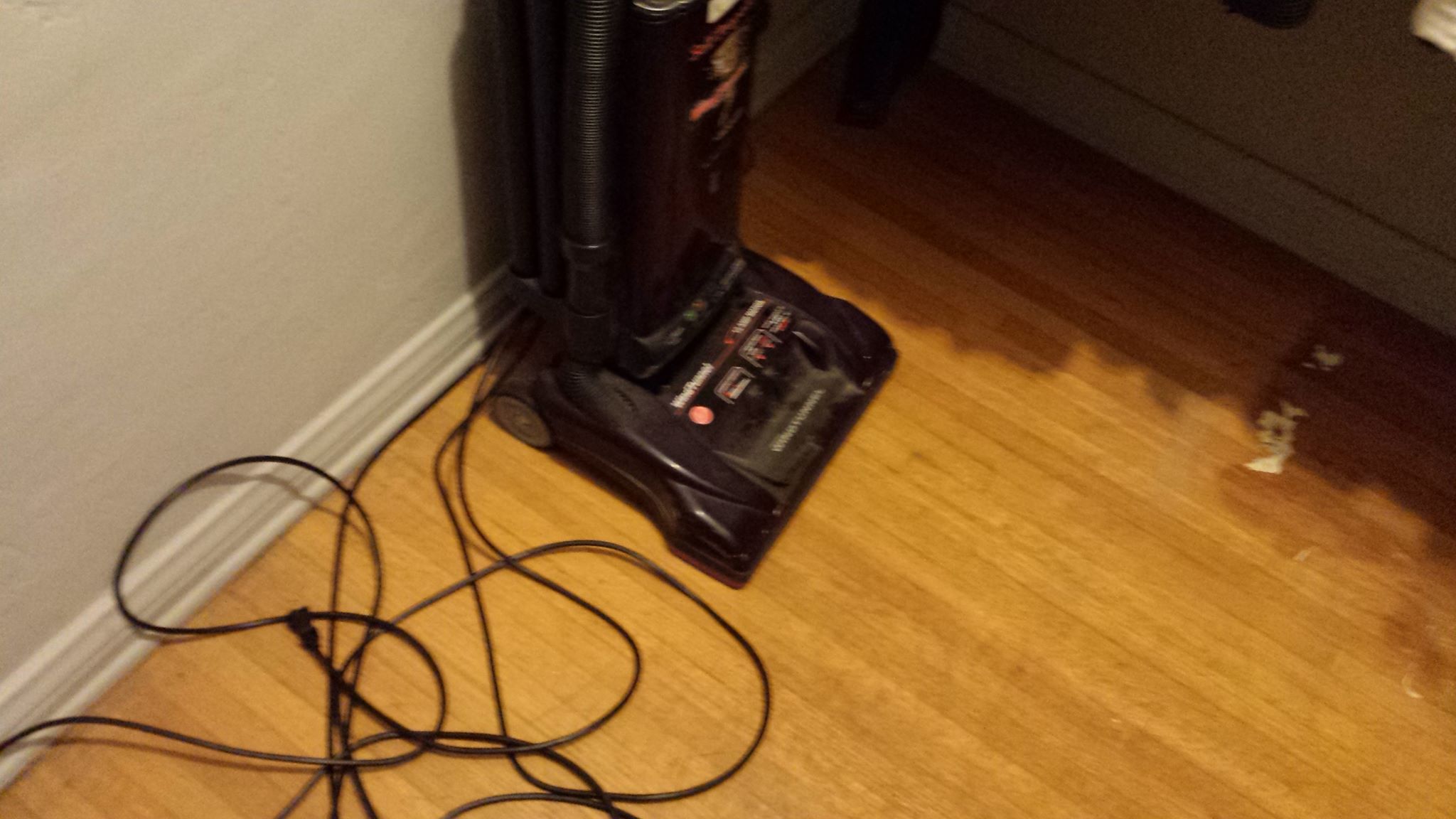

Here you go then. :slight_smile:

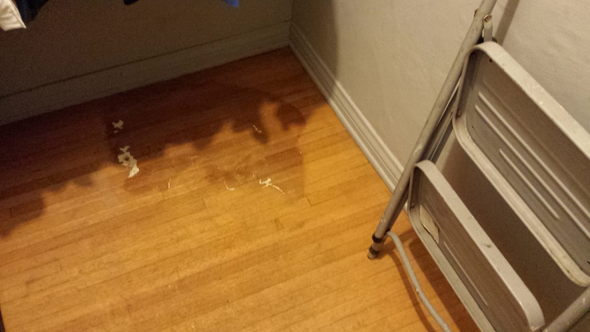

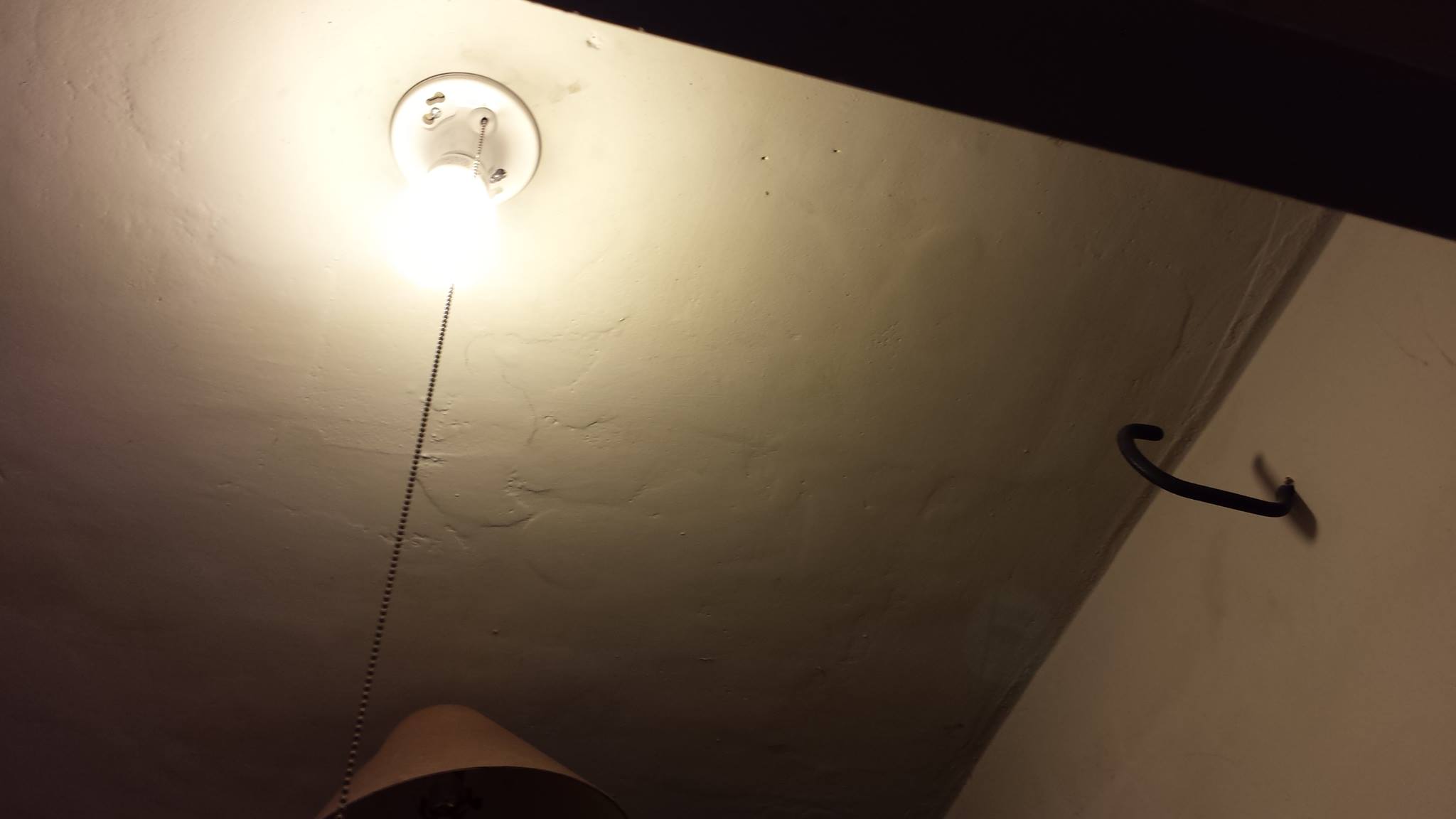

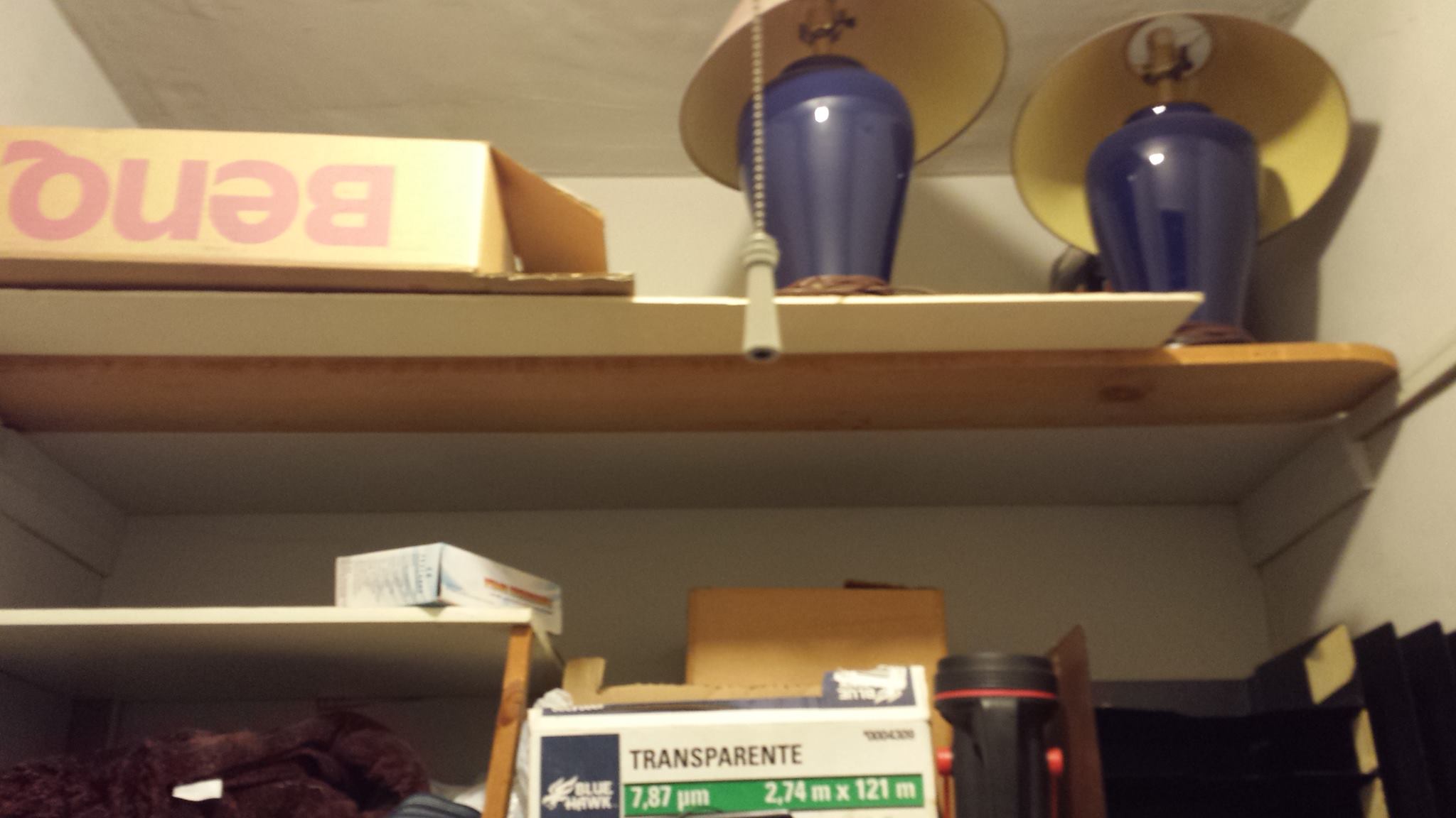

I got most of the emptying done today, the tall chest of drawers, shelving unit and miscellaneous debris.
Just the two shelves to empty and then my clothes to move once I sort out some donation items from my other closets so there is room. :slight_smile:
I left the stepladder and vacuum cleaner in to give a better sense of scale.
Cheers.

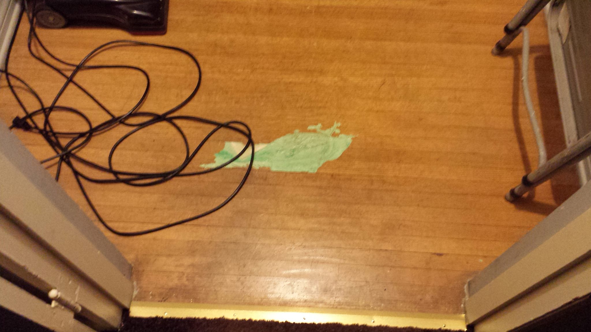

Final two.
I got the first of the two packs I need of the Auralex you advised. That should be enough for the door, some on the walls and ceiling.
I also have some left-over carpet from a recent re-carpeting so I intend to cover the floor with that. :slight_smile:
Cheers.
Leave all the winter clothing in there. That’s two walls you don’t have to process.
Really? Hmm, all right, thanks, I shall consider that.
