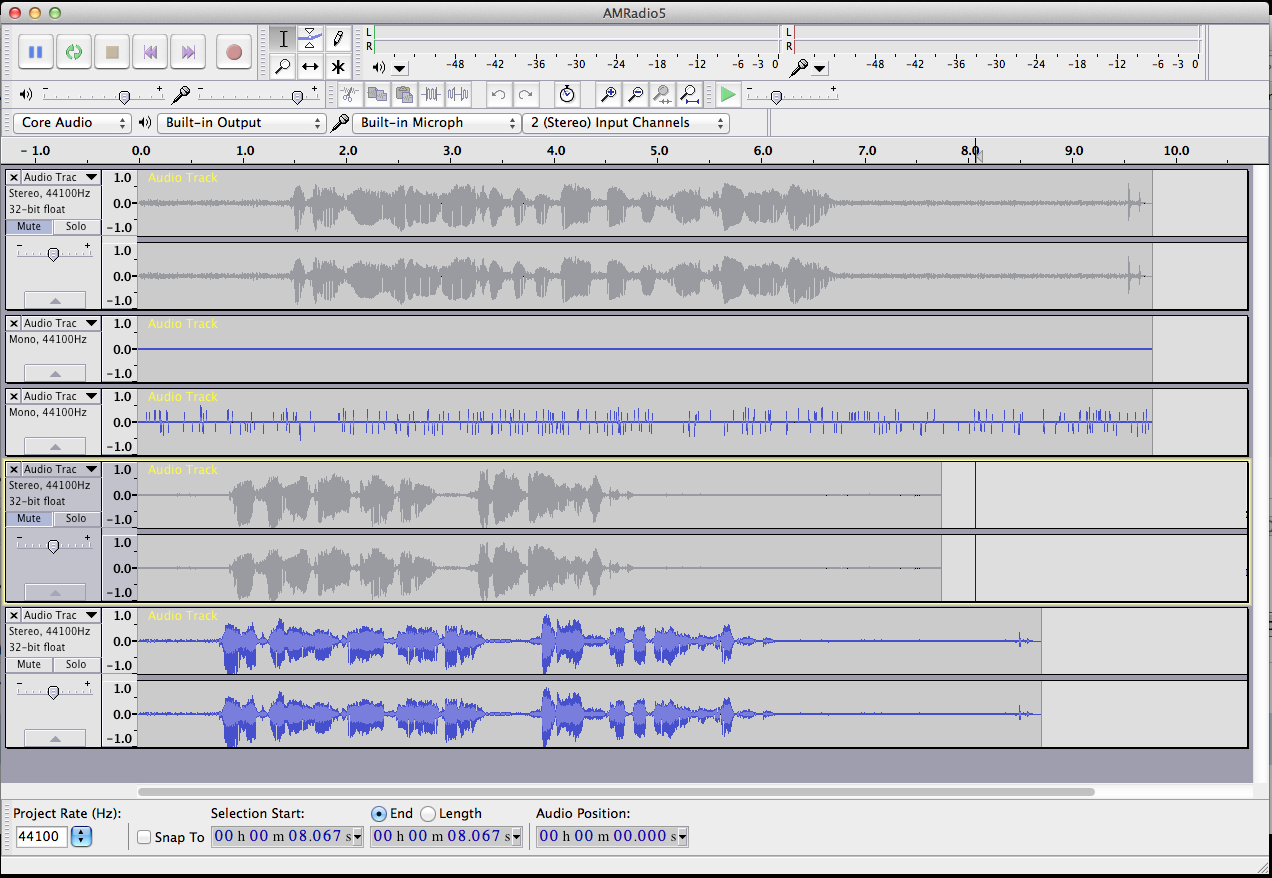

I need to go back and remember how I made the popping noise. I have the project, but Audacity doesn’t remember the effects settings or UNDO.
Attached is the Project screen for AMRadio5. There’s a lot going on and I didn’t clean up after myself, so all the trials are still there.
I do remember the conditions for the voice (track 5).
Record the vocal track clean and apply Effect > Equalization: AM Radio > OK.
Then Normalize to -1.
That’s the basic AM presenter voice. I agree with flynwill that it needs to be a little dirtier. No AM station sounds like that, so try Effect > Leveller at Light or Medium. I got a similar pseudo-processed effect by leaning into the microphone while speaking (that’s my MacBook Pro internal microphone at night in the garden). The up side is no room ambience or echoes. But then there’s the cars and crickets.
Track 2 in that picture is the 5KHz sine wave whistle. Generate it and then Effect > Amplify to a new peak value of -35. Change that number to change the presence of the tone in the show — or don’t do it at all if you think it’s distracting.
Track 3 is the static. The simple narrative version is Generate > Noise: brown. Then Effect > Noise Gate which is then cranked to evil settings you would never use for quality audio. The occasional pops are the extreme peaks of the noise sound with everything else stripped off by Noise Gate. I think Effect > Amplify it so they were louder in the show. I need to get you the particulars about that. That, too can be tuned for theatrical effect.
Audacity will smash all the active tracks together when I export. The gray tracks will not be part of the show.
