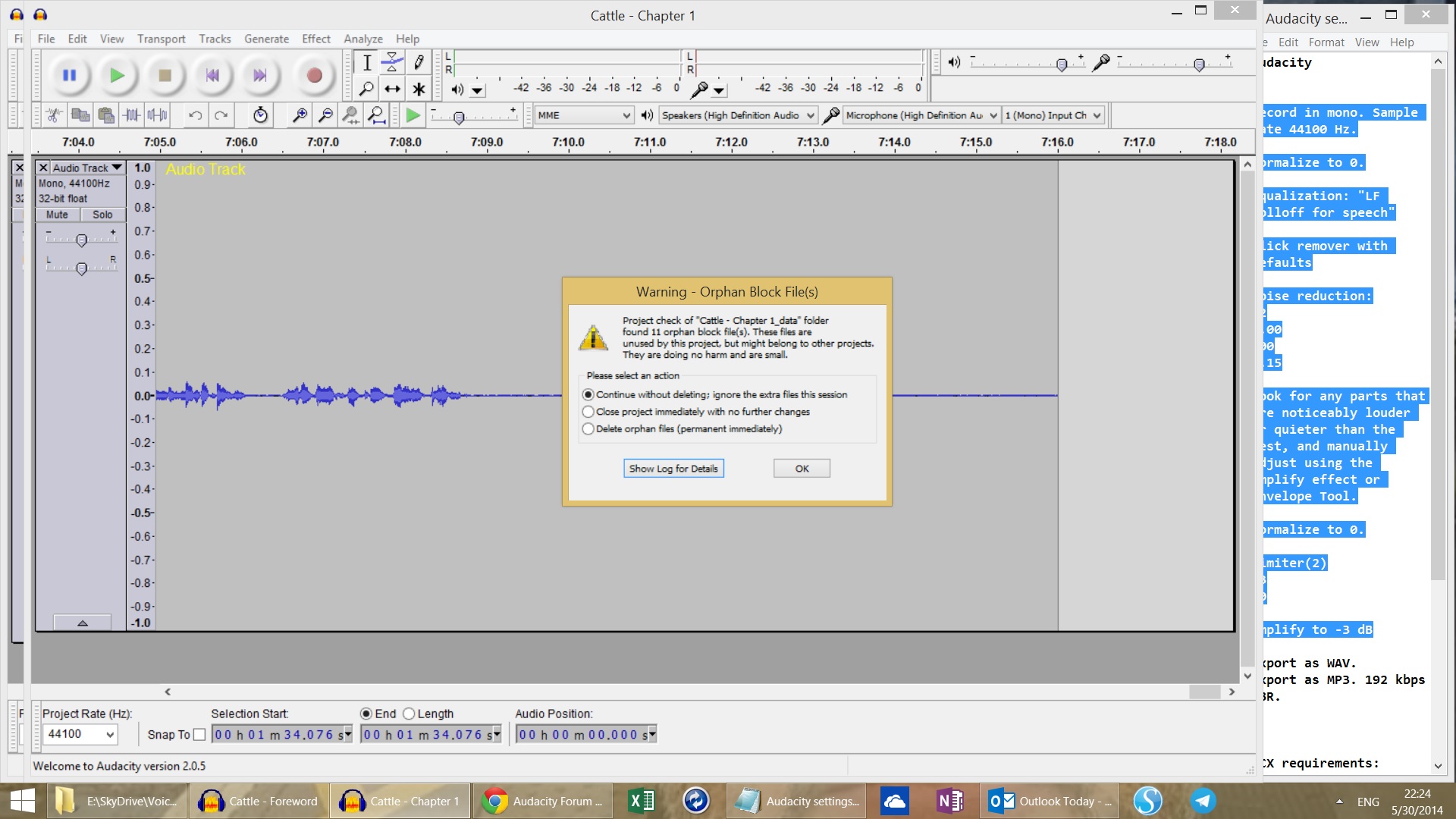

Just when you thought I couldn’t bring you anything else to work on.
Advice please? :slight_smile:

So, are you going to tell me how I work this magic and leave out the whine please?
Oh and the error message too please. :slight_smile:
