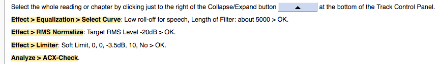

Just for form, we publish a rating tool called ACX Check.
And a mastering suite of tools.
Oddly, you having a ballsy male voice might have trouble with the equalizer step. It’s a rumble filter and you may have voice tones in the range. It may try to remove one of your…features.
The suite is only three tools and you may be one of those unicorns that doesn’t need it.
There is a file management plan. Export each raw reading in WAV 16-bit 44100 and edit a copy or a saved Project.
Export the Edit Master as WAV, and then convert to MP3 for submission to ACX. Do Not use MP3 anywhere else. It’s a very new-user error to announce, edit and submit one single file all the way through. These people are seriously dead if Something Goes Wrong and takes out that one file. The Edit Master becomes your Archive Master and you can save any of the other parts you want. I still have Raw Shoots from years ago. “Say Koz, do you still have that conference room shoot we did with John-Mark?”
