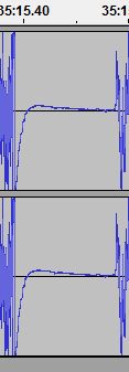

Thanks for the replay, here are detailed screenshots of this gaps:

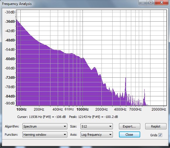

I am probably doing wrong, but I have attached the spectral form of the selection of “Gap1”.
Ok, it’s not “silence”, but I thought that whatever under a threshold “-dB”, let’s say -60dB here , for N milliseconds, could be considered as silence.

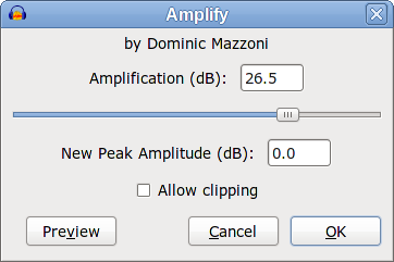

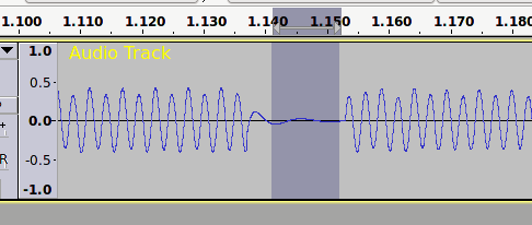

The easiest way to find the amplitude is to select the part that you want to measure, ensuring that your selection is at least as big as the “gap” that you intend to specify:
Then call up the Amplify effect from the Effect menu (do not apply it).
Here we see that the Amplify effect is offering to amplify by +26.5 dB to bring the level up to 0 dB.
That tells us that the current peak level of the selection is -26.5 dB.
Press the Cancel button to close the Amplify effect.
