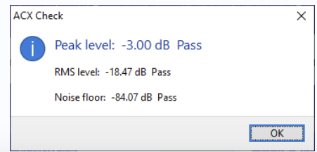

However, when I add the audio to my video editor Camtasia and render the final videos, for some reason Camtasia reduces the dB, and it sounds quieter. And when I import the MP4 video into Audacity to extract the audio and then do an ACX check, the peak is now usually around -4.5 dB:

That and even though you passed ACX-Check, you’re still a bit off.
Screen Shot 2024-07-12 at 5.05.44 PM
Your first example has perfect peaks, but the RMS (loudness) is just about to fail too loud. The loudness numbers are -18dB (loud) to -23dB (quiet). Audiobook Mastering pushes your loudness to a mid point of -20dB (just right) and then trims your peaks to -3.5dB.

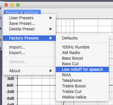

— Apply Rumble Filter (Filter Curve Eq).
Screen Shot 2024-07-13 at 7.03.35 AM

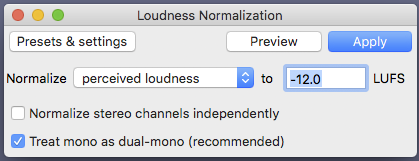

— Loudness Normalization.
Screen Shot 2024-07-13 at 7.02.26 AM

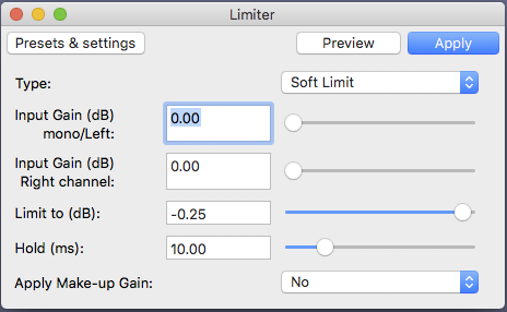

— Followed by Peak Limiting.
Screen Shot 2024-07-13 at 7.01.57 AM

Sorry. Doing this before the Starbucks kicked in. That first tool is Filter Curve Eq.
Screen Shot 2024-07-13 at 7.23.19 AM

Note the limiter is Soft Limit.
That processing should sound pretty much like you except louder.
