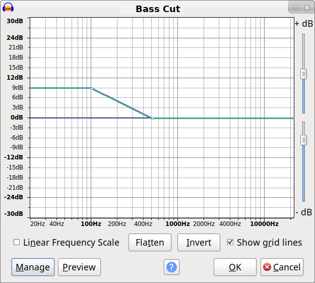

So let’s say that you selected a preset called “Bass Cut”, and this is what you see:
Which are you going to believe - the preset name (displayed in the title bar), or the frequency curve?

Maybe you modified a “Bass Cut” user preset some time in the past and forgot to change the name, or you entered a nonsensical name when you created the “Bass Cut” user preset?
