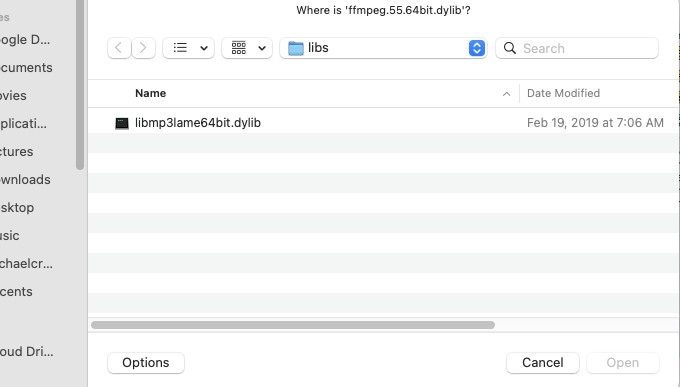

Hello - I’m trying to add FFmpeg to Audacity 2.4.2. I’ve followed all the instructions, but I am now in a loop. The FFmpeg library ended up in Library/ApplicationSupport/audacity/libs. No squiggle in front of the path. So I guess it’s in the wrong place. And so Audacity keeps looking. The screenshots below will show the loop. How do I get the FFmpeg installed? Thanks.
Look at your third screen-shot. That’s the LAME library, not the FFmpeg library. Try again to install the FFmpeg library.
– Bill
Thanks. It works now
– Bill
I also get this at this page. The top reads “Lame MP3 Export Library”. The bottom reads, “FFmpeg Import/Export Library”. Thats where the “Locate” button is that we use right?
