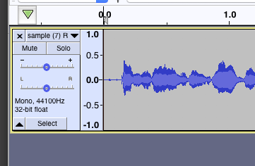

Oh. One more. Most voice work is produced mono. One blue wave.
Pull down menu on the left > Split Stereo to Mono.
Delete one of the tracks.

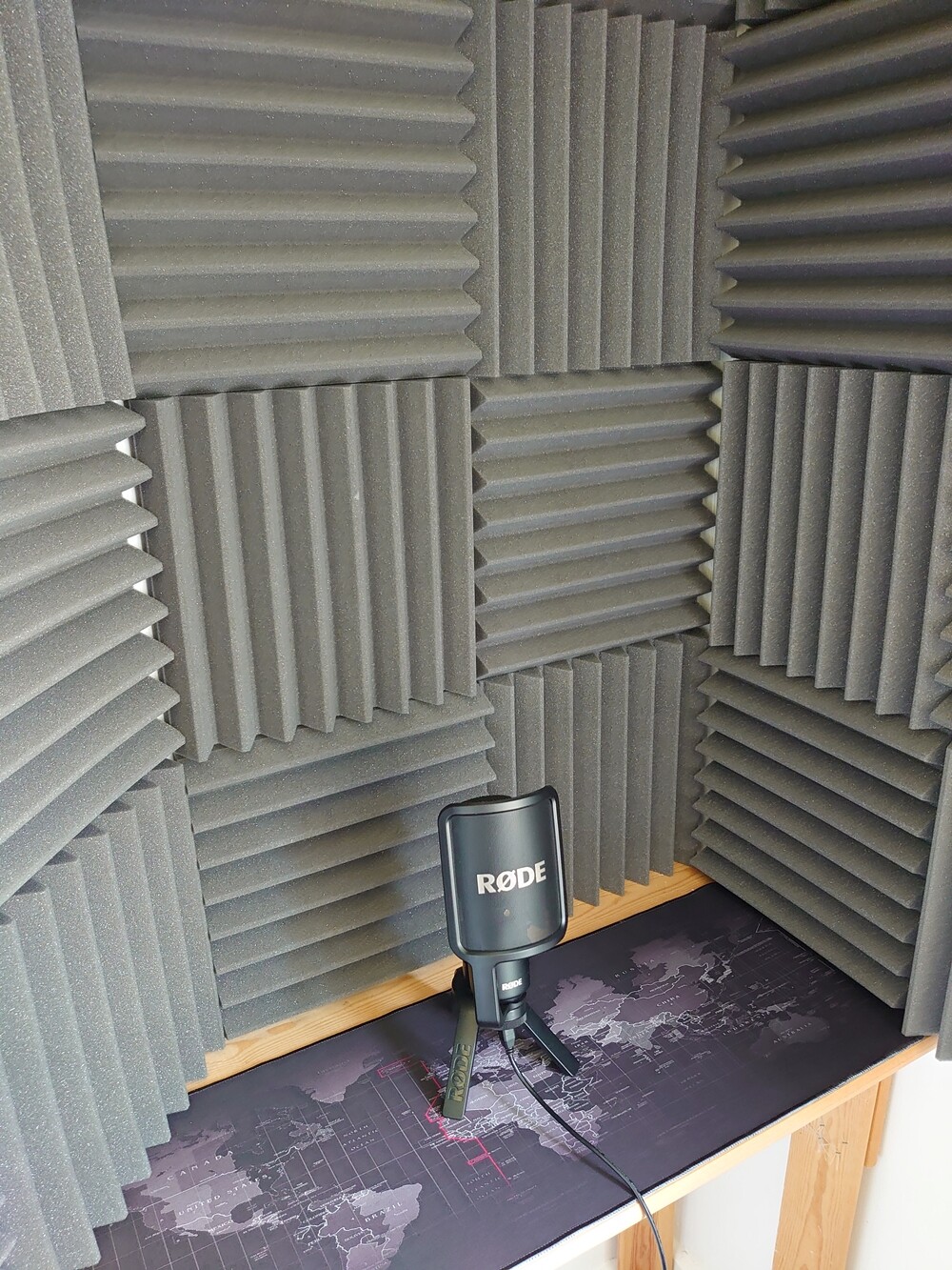

My friend has sent a picture of her setup, which I’m attaching.
The mic is a Rode NT-USB (which seems to get pretty favourable reviews for a budget model) but I don’t know what distance she was working from it: possibly a lot more than would be ideal, in view of the sound. I think those are Scan acoustic tiles.

Note that in this home studio setup, there is a heavy blanket on the table.
https://forum.audacityteam.org/t/too-compressed-rejection/52825/22
That’s not an accident. You can get reflection sound distortions from a hard table and a simple tripod stand.

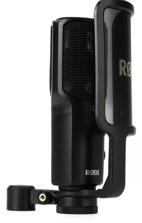

Just to cover it, most microphone of that type are side-address (talk into the side) and you speak into the company name. It looks OK in the pix, but checking is nice.
This one?

Note that in this home studio setup, there is a heavy blanket on the table…
That is a splendid setup. The hard desk top possibly being a problem had occurred to me, but would reflections from that and the stand be enough to account for that poor quality?
Just to cover it, most microphones of that type are side-address (talk into the side) and you speak into the company name. It looks OK in the pix, but checking is nice.
I shall.

The little three-legged home microphone mount is insanely convenient from Marketing and Publicity’s view, but it’s probably the worse place to put a microphone to actually record anything. Sound reflections from the desk can give you a little talking into a wine glass voice (Comb Effect). There is a sound example I haven’t recorded yet. Start with the microphone flat on the table and then, while announcing, lift the microphone straight up. Right about 5 to 7 inches (12cm-18cm), you get odd tonal shifts, missing from flat on the desk and elevated. You can get around most of that distortion with the heavy blanket or towel on the desk, but most home users did exactly what your presenter did. Bare desk and tripod mount.
Nobody wrote you can’t have more than one problem. It’s such a pronounced effect that it’s likely there is more than one problem.
Sure enough, there is one (1) home microphone available with the company name on the back. That came up in the forum postings. Just when we thought we had a convenient rule.
