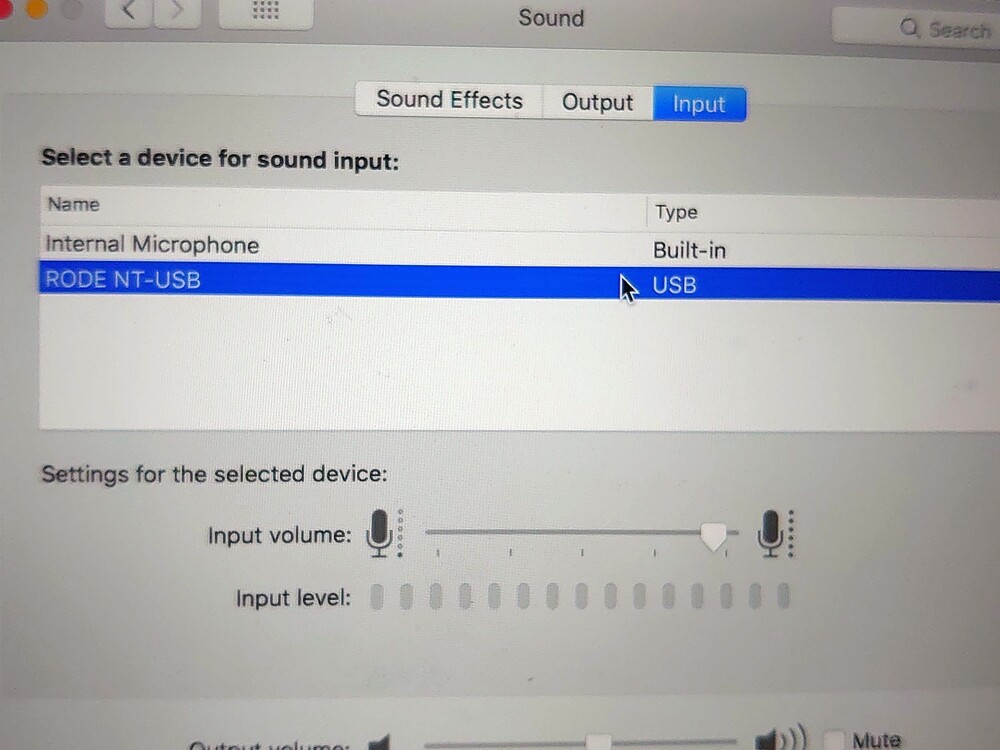

An update: my friend just sent through a couple of new tests, recorded at a fist-width from the mic. I’m not going to post either of them because they sound almost identical to the previous recording. I also asked her to scratch the windshield before speaking: nothing is audible.
Edited to add:
It was the laptop microphone that was active. Many thanks to Trebor who was the first to suggest it! This despite the fact that my friend reports the exterior mic being selected in the software: she’s using Quicktime on a Mac machine. A curious fault, if it is one.

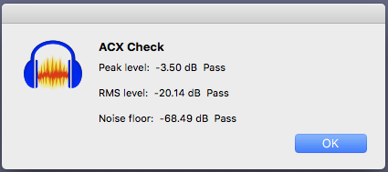

OK, here we go: a new test recorded on a different machine:
Much better. I applied Audiobook Mastering tools and it passes ACX technical testing.
