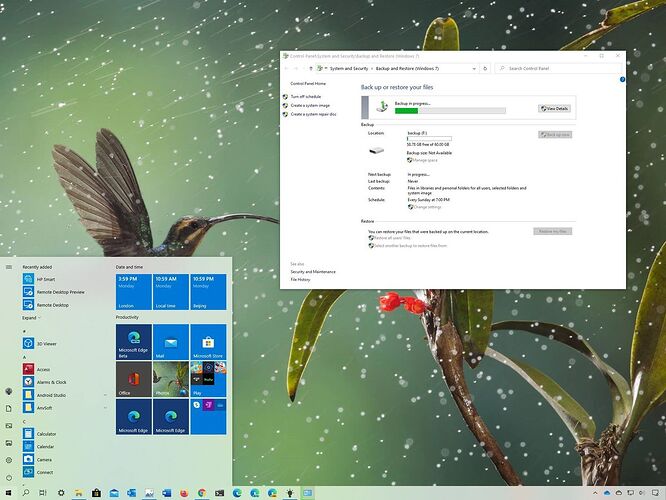

Why did you think that? Did you set up an automatic backup task? Windows has one.
https://www.windowscentral.com/how-backup-windows-10-automatically
And you can do it using third party software.
