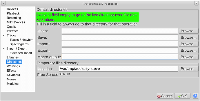

In the Export window it says to leave field blank to go to last folder used, that does not work.
In version 2.2.2 I leave blank and it always goes to that last folder used.
Having to go to Preferences & change destination each time is a real pain!
If you set a default folder for any of those actions Audacity will always offer that folder location when you invoke that action.
If a particular action’s default folder is left blank (default setting) then Audacity will offer the last-used location for that action.
If you leave the entry for Macro output blank then Audacity will default to creating a folder called “macro-output” in:

but the text in the GUI (highlighted in my previous post) is wrong / misleading as the macro output folder does not “go to the last directory used for that operation”. The text in the manual appears to correctly describe the actual behaviour.

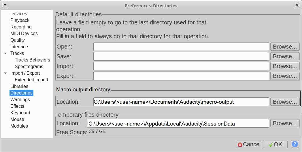

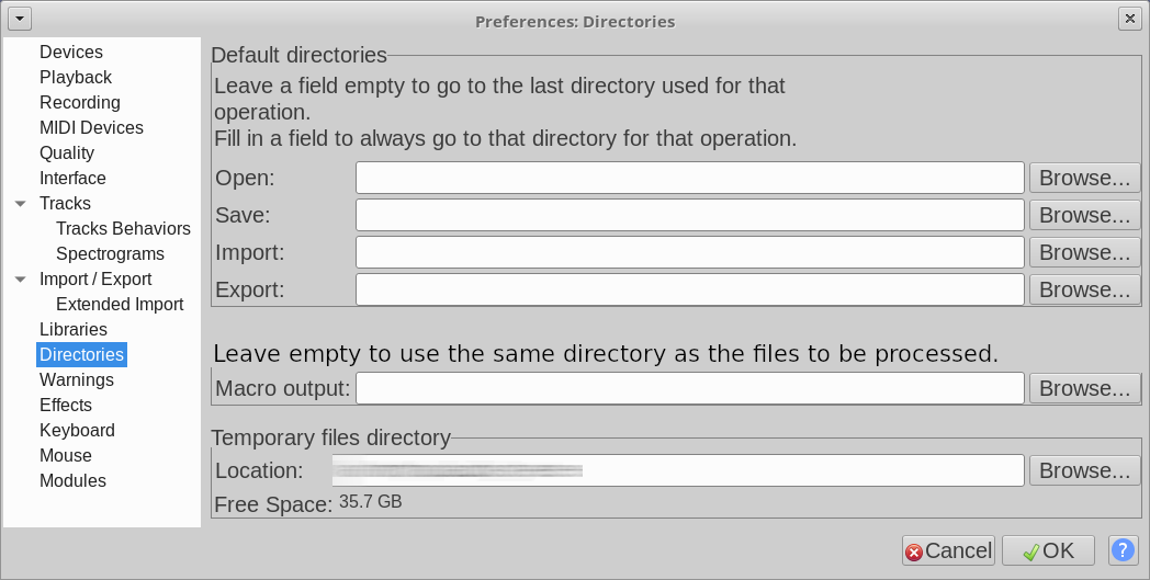

It would make eminent sense to separate the “Macro output” entry from the other 4 in the prefs dialog and
a) pre-populate it with the default
b) clearer explanation of behavior
c) prevent the user from making that field blank ever.
Yes but that solution is a reversion to “the old ways” something you manifestly failed to convince James to do when he was implementing default directories in directories prefs for 3.0.2
By all means post your alternative on GitHub, it could certainly work that way (may require a bit more coding that my suggestion on GitHub) - anyway it’s not our call anymore, it’s a call for MUSE to make.
But yes I agree with you that the dialog as it stands is incorrect in regard to macro-output folder location. IIRC I think I mentioned that to James at the time, but he did nothing about it.
So here’s another solution - the one I posted in GitHub:
It would make eminent sense to separate the “Macro output” entry from the other 4 in the prefs dialog as a separate block (as is the case for the temporary files directory) and:
a) pre-populate it with the default (as shown in the 3.0.2 Manual)
b) clearer explanation of behavior (the text for the other 4 default directories just does not apply to Macros)
