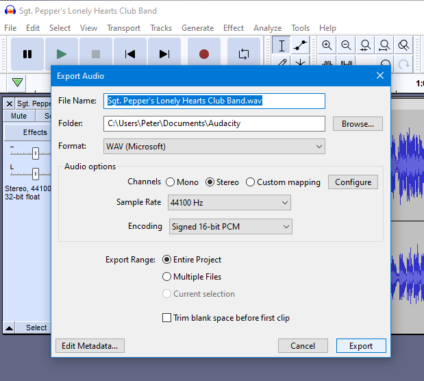

In the upcoming 3.4.0 release the Export dialog is upgraded to give you full control over these and other parameters at export time.
The dialog for Export will look like this:
Peter
