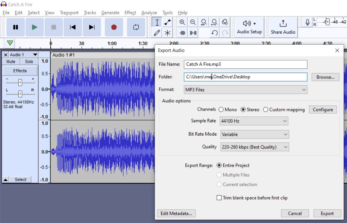

Hi, All.
This is on a Windows 10 Home with Audacity 3.4.2.
First time trying to export one LP into multiple mp3 tracks.
The ‘Multiple Files’ option is greyed out.
Project is saved. Playback stopped. Neither muted or solo. I don’t need the track names or numbers. (I can enter that later.)
What am I missing ?
Thanks.
It will be grayed out unless you have either
a) a label track with at least one label
b) multiple tracks
Just as Current Selection will be grayed out if you have no selection present
Peter

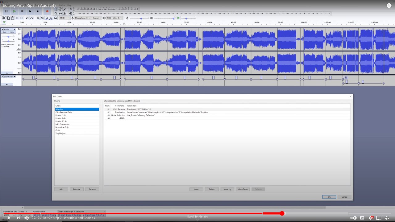

Hi All,
I was ripping some vinyl today and have been quite happy with the method demonstrated in the video link here:
The creator of the video shows a really useful, straightforward and easy way to (1) break the recording into individual tracks, (2) rip the files, and (3) go out to the internet to automatically pick up the names of each of the songs. He also gives a good method to minimally compress the songs (which I don’t follow) as well as reduce low frequency noise (which I do follow.) It really is a superior workflow, much better than I’ve used in the past. (So hopefully the site rules allow one to post a link…). If not the author’s YouTube name is “Hairybonch” (whatever that is…) so a search would probably pull him up.
