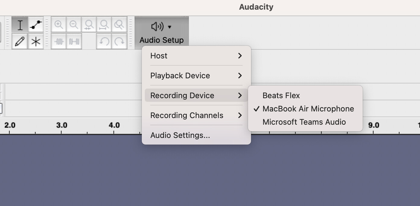

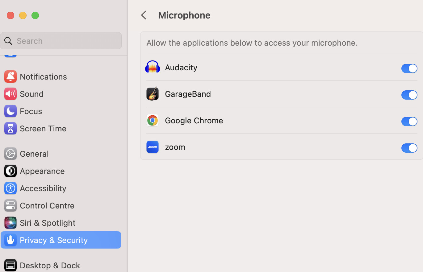

Hi Bill,
Audacity already has access to the microphone - I haven’t changed anything here (see photo)
And the recording device is already pre-set to ‘Macbook Air Microphone’
Is there anything else I should check?
