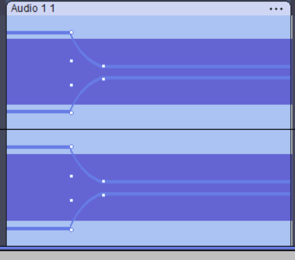

With the most recent update (3.6.1), the tracks I’ve applied enveloping to all show up on my timeline at full volume. When played, the volume of tracks still changes correctly, but the wave form remains unchanged, reducing properly aligning tracks as they fade in and out to guesswork once no longer using the envelope tool. To illustrate, here’s a flat tone that I’ve enveloped:
Screenshot 2024-07-22 183143
The placement of the control point on the right should be changing the shape of this waveform, but it remains the same. Only moving whatever control point is leftmost on a clip does anything.

Thanks for flagging this. We’re experiencing the same issue on some clips, and not on others, exactly as described in this thread. Here is a screen recording to show what happens.
