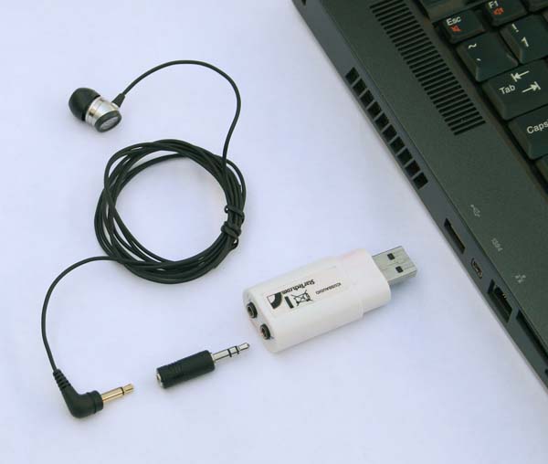

This is an Olympus TP-7 microphone.
It fits in your ear and you hold the phone on top of it. This is my TP-7 plugged into a Windows machine, but you can plug it into a tiny memo recorder and have the whole thing portable for field recording.
I don’t have samples of a fully portable recording or pictures of the memo recorder. Soon.
