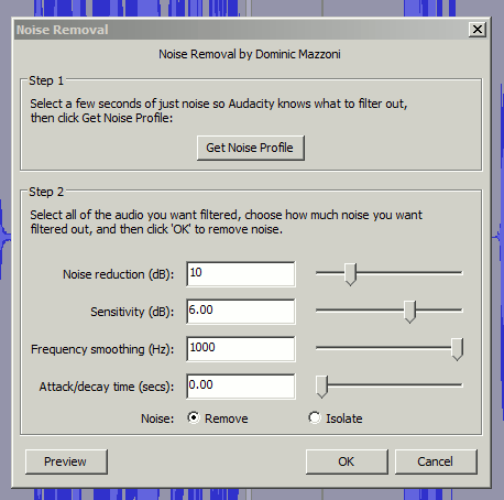

Below is a “before-after” using the audio you posted previously with the noise reduction settings …
After Noise Reduction then apply a noise-gate to reduce/remove the noise between phrases.

You’ve left out a step – select a “noise only” portion of the recording, do Effect > Noise Removal and click “Get Noise Profile”.
– Bill

  3. Apply Audacity’s native Noise Reduction with the settings: 10dB, 6dB, 1000Hz, 0 seconds , remove .

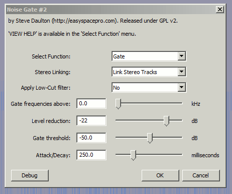

5. Select any conspicuous unwanted noises between phrases, e.g. 11.40-11.60sec, press “Ctrl” +“L” to silence them.
Then select the entire track and apply a noise-gate to squelch the noise between the phrases.

that very low level of noise is inaudible. If you change the "level reduction " on the noise gate to -100dB it will make the silence truly silent, flat-line, however there won’t be an audible difference from the current -70dB level unless you amplify it by an unfeasibly huge amount, (the voice will be clipped if you amplify the track by more than 1.4dB).

There is no need apply 36dB gain, doing so is unfeasible: if you apply more than a couple of dB gain the peaks and troughs of the audio with speech will go off the chart and be horribly distorted by clipping. In step 5 the I set the “level reduction” on the gate to -22db which took the noise below -70dB : that’s good quality. If you must have flatline silence push the “level reduction” on the gate to the extreme of -100dB. However having flat-line silence between phrases can sound weird : if you leave a long pause listeners will think they’ve been cut off, leaving a tiny hint of noise between phrases is preferable to removing it completely which sounds unnatural.

You’ve not done all of Step 5 : silence any conspicuous unwanted noises (spikes) which occur between phrases …
silence spikes by selecting them and pressing 'Ctrl' +'L', then apply noise-gate.gif
, then apply the noise gate.

The noise gate will still function if you do not manually remove these noises, but it will perform better if you do.
If you set the threshold of the noise gate higher, say -30dB instead of -50dB, it will remove more of these noises automatically, but there is then a danger the beginning and end of words will be chopped off.
