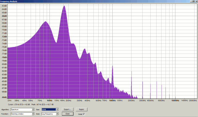

Koz is right : there is a peak in the background noise a 171Hz, (sounds like a fan), for completeness you could notch it out, but I doubt anyone will notice the difference, particularly after you’ve squelched the noise between phrases to flat-line. The ear is not equally sensitive to all frequencies , the 1KHz tone and its harmonics (2,3,4,5,6,7,8,9,10KHz) were more audible than the 171Hz , which I why I suggested they be notched out.
Try notching out the pulsing 171Hz noise on a section of audio as an experiment, ( a lot of this stuff is by trial and error).
Steve’s limiter plug-in (step 6), like the levelator, performs dynamic range compression. Taking two passes at dynamic-range-compression with different tools does occur, (i.e. using Steve’s limiter then the levelator could be OK ).
