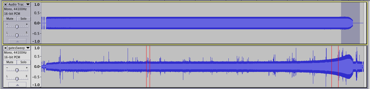

I’d expect not, but did you realize that “flat-topping”, after the sine tone has been removed looks like this:
Which is harmonically identical to this (only difference is the phase relationships of the harmonics):
and it has a spectrum that looks like this:
(Well I guess that you would expect that koz, but I think it is quite surprising the first time that you see it).
