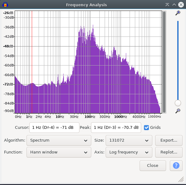

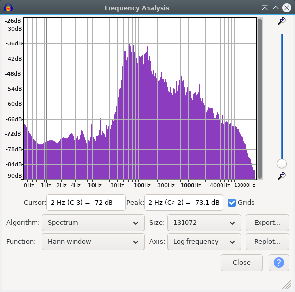

This is the uncompressed spectrogram:
And the 1000th encoding spectrogram:
