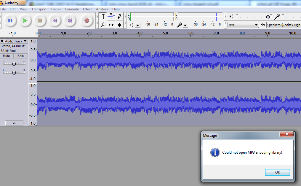

Hey all,
Running out of solutions here. Installed Audacity 2.0.3 via .exe package. Currently on a windows 7 64 bit system. Everything is working wonderfully except trying to get Audacity to locate/use the LAME encoder.
I’ve tried installing every LAME encoder from 3.98.2 right up to 3.100.a with no success. I’ve tried editing the audacity.cfg to either remove the MP3 lines as per a help document, and I also tried physically adding the path.
Trying to use Edit → Preferences and locating the Lame encoder doesn’t do anything. No matter how many times I’ll point Audacity to the file and hit ok, it still says “Could not locate”
Tried placing the file in the Audacity folder, in the default C:Program Files (x86)Lame for Audacity, even tried it on the desktop.
Each time I’d change something I would ensure Audacity wasn’t running.
I’ve adjusted security settings on the Audacity and Lame folders to allow/modify all for all users/levels.
I’ve tried running it as Administrator to no affect.
Anyone have this issue or know a work around? I have two podcasts to get done and out today so I’ll have to export as WAV and use some third party encoder. :frowning:

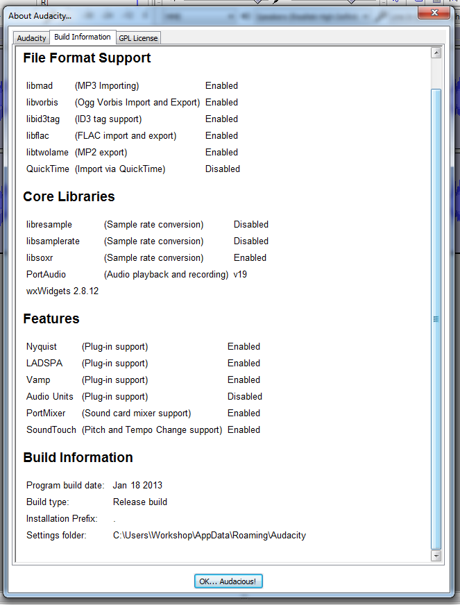

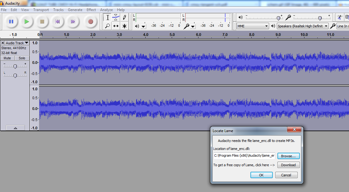

Hey,
Just tried that again. Still no go. I have attached screen shots.
Audacity is installed as per default: C:Program Files (x86)Audacity.
Damien
One more picture. Let me know if they are too big and I’ll upload them to my FTP and make them links.
Damien
