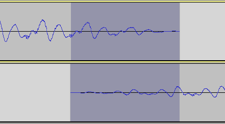

  1. Audio with DC off-set pasted into a track that has Audio without DC-off-set.
    In this image you can see that the highlighted clip on the right is shifted vertically up above the 0.0 centre line (DC off-set).
    During playback, there will be a small click at the edit boundary due to the signal suddenly jumping up to the second clip.
DC off-set is frequently due to recording with a faulty sound card, though some (faulty) format conversion programs can also cause it. The “Normalize” effect can be used to remove DC off-set, as will a high pass filter.
  1. edit point chosen incorrectly.
In the example below, the edit in the upper track will click, while the edit in the lower tracks will not:
While making the edit occur at 0.0 on the vertical scale will prevent clicks at the edit boundary, it will not necessarily make the edit “seamless”. If one sound suddenly changes to a different sound, (for example a piano note suddenly becomes an electric guitar note), the sharp transition will still be apparent.
