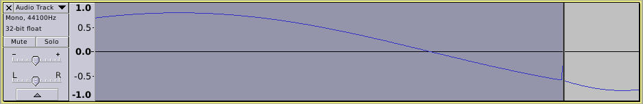

If you want to stretch the signal longer, you will need to apply the effect to a longer selection and then trim it, rather than the other way round.
When stretching longer, the resampling interpolates new values between each successive sample value. The problem at the end of the selection is that there is no “next sample value”, so resampling interpolates between the value of the last selected sample and “nil”, which is interpreted as “zero”, hence the dive to zero at the end.
I did use the effect on the whole track, not on the selected part you see in the first picture. I thought I had to point that out because it looks a bit confusing.
Of course…thanks a lot, again! Hope you are not getting tired of my messages : )

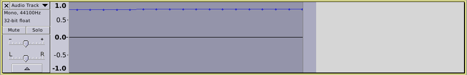

If you stretch this to double length
You get this:

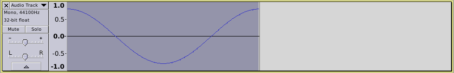

On the other hand, if you stretch this to double length
You get this

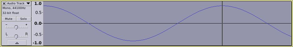

which you can then trim to this:
Yes, this works, thanks again for your help!!
