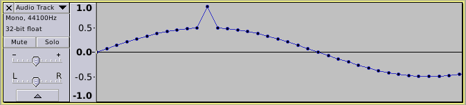

For testing you may find it useful to use the Draw tool (http://manual.audacityteam.org/o/man/draw_tool.html) to make one sample noticeably higher than the rest.

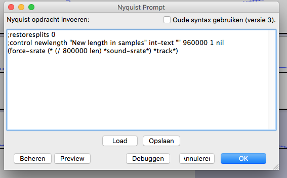

This is the basic code. To make this into a plug-in (rather than running in the Nyquist Prompt, you could just add the appropriate headers (must be a “version 4” plug-in): Missing features - Audacity Support
;restoresplits 0
;control newlength "New length in samples" int-text "" 44100 1 nil
(force-srate (* (/ newlength len) *sound-srate*) *track*)

Very last question, your last codes has 44100 1 nil,
I’m working with a ridiculous high sample rate of 960kHz, so I changed it to 960000.
However, when using 44100 instead it still works fine, is this normal?
so to speedshift to a length of 462058 samples I use:
;restoresplits 0
;control newlength “New length in samples” int-text “” 960000 1 nil
(force-srate (* (/ 462058 len) sound-srate) track)
This line creates a control. For it to work in the Nyquist Prompt requires Audacity 2.1.1 or later.
The syntax is described here: http://wiki.audacityteam.org/wiki/Nyquist_Plug-ins_Reference#Nyquist_Plug-in_Widgets
Running the code in earlier versions of Audacity will treat the first line as a code comment (the line is ignored).
As you can see, the number “44100” after the keyword “INT-TEXT” is just the default value for the control. The following “1” is the minimum value and “nil” (for numeric-text controls only) means that the maximum value is undefined.

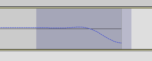

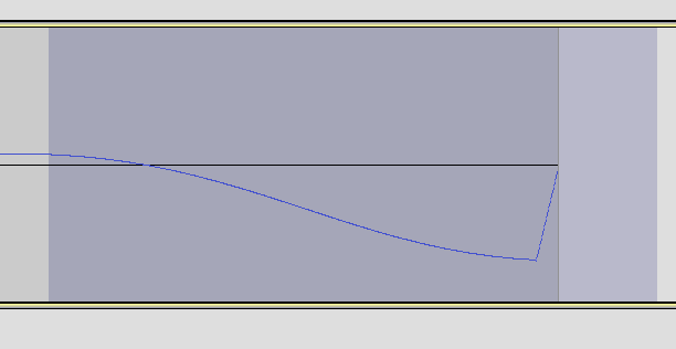

Hi Steve, is it possible that the code to speed-shift a track to a specific length contains bugs?
It seems to have kind of ruined my perfect loop points, see attachment…
