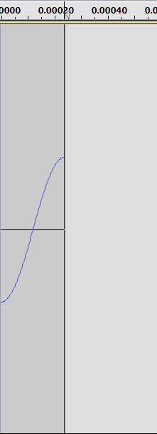

Additional to my explanation on the previous page, here are some pictures of before and after the effect I need:
before: a selection
after: the beginning of the selection is cut until the sample right before the highest sample (the highest sample is not cut).
I could also use the opposite: the highest sample or peak is cut until the end of the selection (this time the highest sample is also cut)
