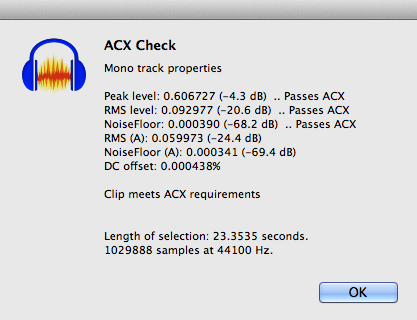

clips meets ACX standard but I got rejected because -60db noise reduction
Much closer. I applied the mastering tools and got it to pass the technical tests.

You could submit that and it would pass the technical tests (a machine does that), but it may not pass the second test where a real person listens to it for sound quality. We are trying to get your voice in good quality for the Italian performance, right?
– Listen to the first six seconds of the file you sent me. Turn the volume up. Do you hear the ticking, shuffling, popping and other noises? That’s supposed to be only the room noise, not you shuffling in your seat or whatever you were doing. Do you have a drink of water or something in the room? That may have been some of the noises. Do Not Move during Room Tone.
– Does your room have bare floors and walls? You have echoes and it sounds like you are announcing in a big empty room or a bathroom. There are no filters or corrections for that in Audacity.
– You are still overloading your sound recorder. The blue waves should not look like little square blocks.

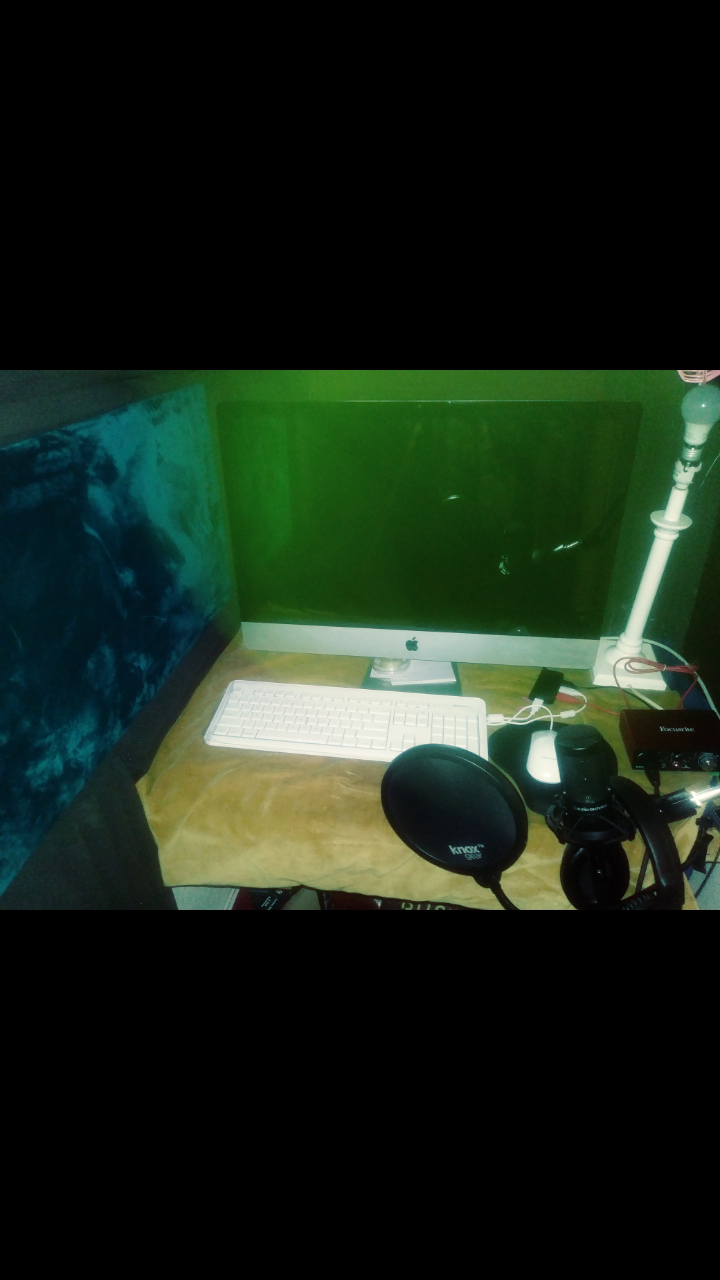

Well, I have no ideas on how to remedy this. I use the screeny to view scripts and monitor audacity. It gets loud after being on a while. Typically I record early or super late and the motors not so overworked.
i replied but cant see it. Im replying via cell right now.
my set up is in a walkin closet. one side has been converted to hold the monitor, all hard surfaces are covered. But with an entire engine near the mic, it really doesnt matter, I guess. the monitor and keyboard are all together on the same desk. I have no idea how to fix this issue. It seems segregation of monitor and mic is the proper solution.
I’ve attached a pic of my set up. I gotta figure out the best way to deparate mic from on again off again ridiculously loud monitor fan.

I didn’t know those monitors had vent fans.
The presentation is close. With careful noise reduction you can get there, but too much noise reduction can give talking into a milk jug distortion to your voice. I don’t have an inside track at ACX, but I suspect strongly they watch (listen) for that milk jug sound to complain about excessive noise. In that case, you didn’t actually fail technical conformance. You failed the second step, Human Quality Control—the theatrical test.
Another name for that distortion is “cellphone sound.”
The only solution I know of is don’t bring the computer and fans in with you. People have set up computers outside the studio and run wires inside for keyboard, mouse and monitor and USB Microphone. That can have problems, too, because high quality microphone USB cables will not go long distances.

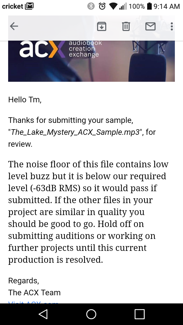

Well, check this out. Here’s the response I just got today from ACX on the sample. But clearly, I’ve got work to do!
So I’m slowly emerging from Frazier down on the mat back to the standing tall Ali…I’m gonna figure this thing out! Oh and to answer your question about where my script would be, an Ipad. I’m addicted to highlighting my characters or unknown words in various colors as a reminder on how to pronounce and to pitch up or down.
…It would pass if submitted…
Pretty much my comments. “It’s r e a l l y close.”
The problem with ‘really close’ is no room for error. If you do anything at all wrong, you could fall off the end of acceptance. And, see, I’m not the only one that can hear a buzz back there. You mentioned that your room can heat up and the fan gets louder. You’ll need to stop reading when it does that.
