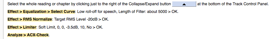

Then apply the Mastering tools from here.
Scroll down to Process. That’s the abbreviated instructions like this:
Then apply noise reduction of 8, 6, 6.
In my audacity I can’t find Low roll-off for speech
is in the equalizer?
Your version of Audacity may be too old. The current version is 2.3.1 and it is available via the Audacity website: Audacity ® | Downloads
