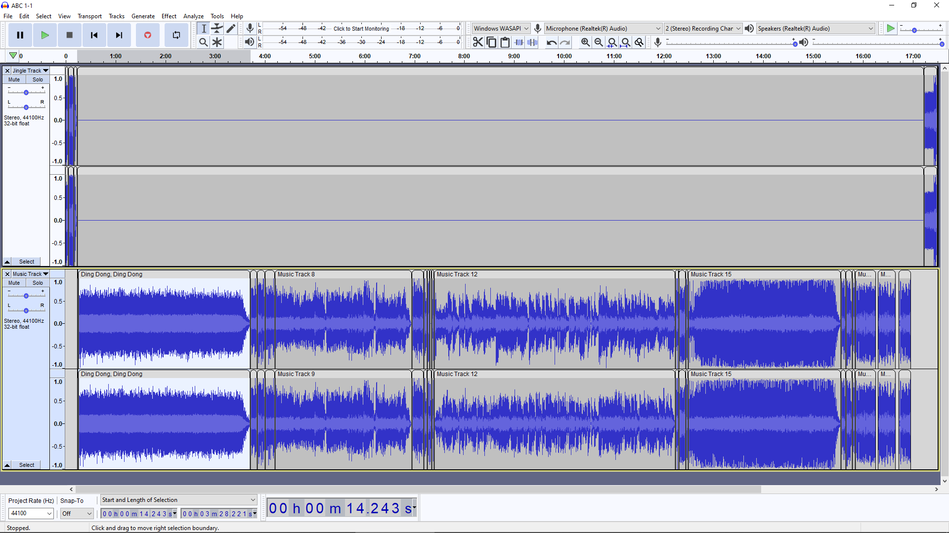

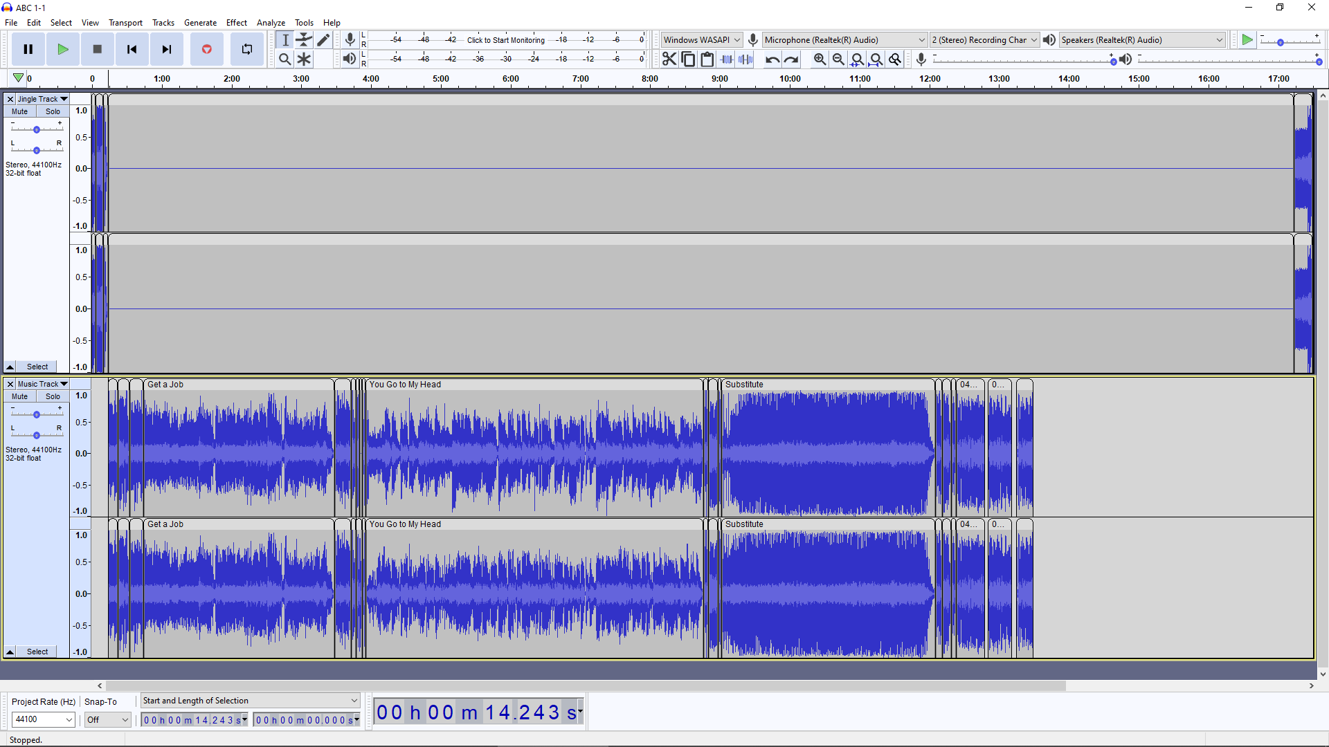

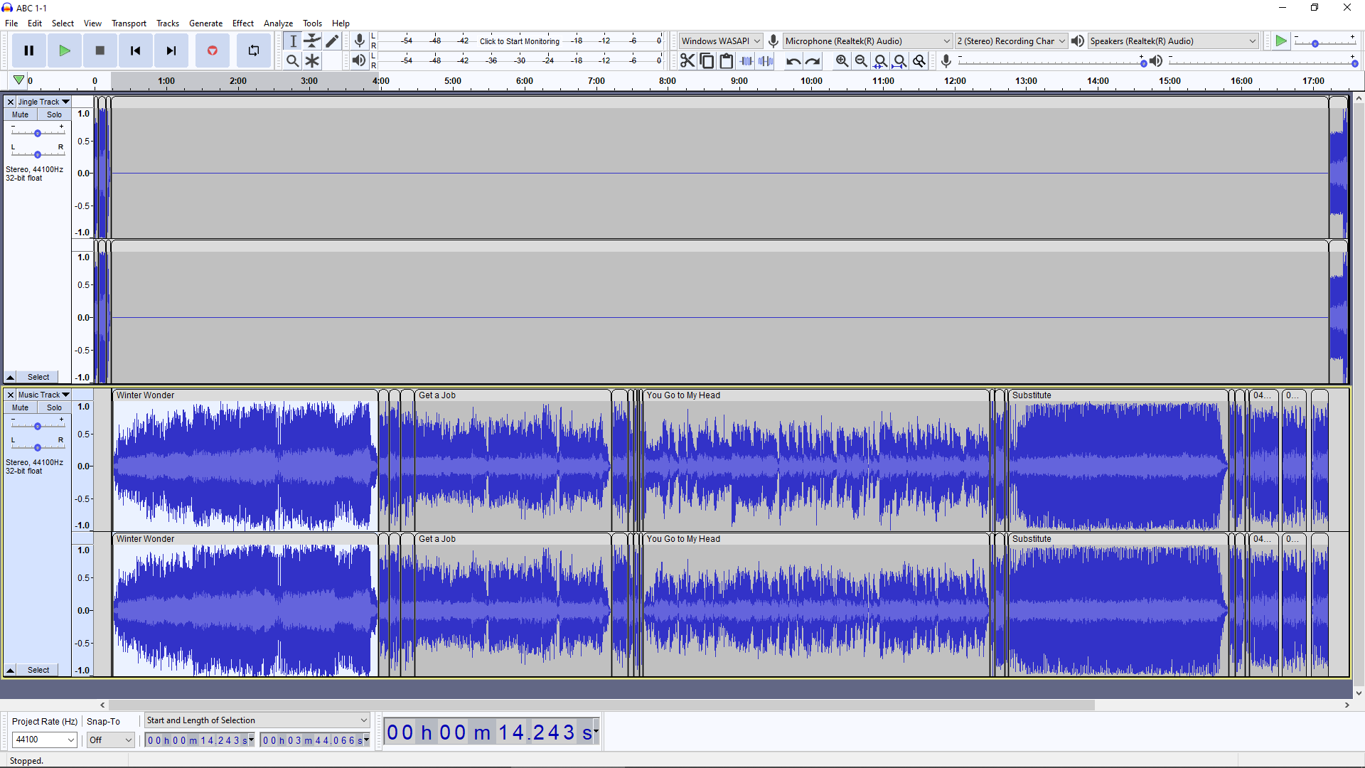

It seems there’s still a problem with clip names being corrupted. The clips in the screenshots were correctly named when opened (a). I deleted the first two clips (b) and inserted two clips at that point (c). You’ll see the other clip names have been replaced by ‘Music Track n’. This issue has plagued clip names since they were introduced and it’s not worthwhile naming them while it persists.

I double-clicked on ‘Winter Wonder’ to select, then F9 to add the short clip before it. I deleted them, then selected ‘Ding Dong, Ding Dong’ and the short clip before that from another project, then inserted them at the cursor point. That’s when the clip names were corrupted. I’ll try moving clips separately to see whether that affects the issue.

Found it - the issue occurs when moving multiple clips, which wrecks the names of subsequent clips. When they’re moved separately the names are preserved. The obvious solution is to move them separately but it’s worth investigation and correction.

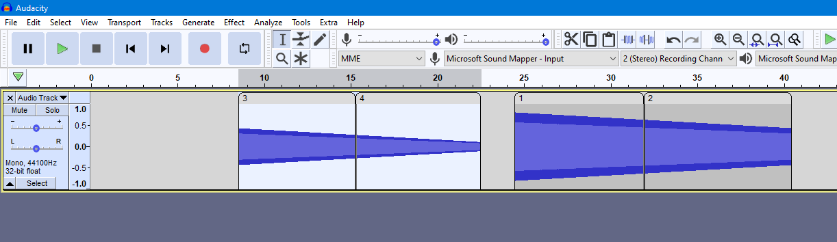

My steps
  1. created a chirp
  2. moved it along the timeline to create some space
  3. split it into four clips
  4. Labelled the clips: 1, 2, 3 & 4
  5. Selected clips 3 & 4
  6. dragged into the space created on step 2
  7. Observe all looks fine
    I can drag the 3&4 clips back ad forth and all remains fine :confused:
