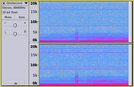

Click on the track name and select “Spectrum”.
The click is now clearly visible, and is actually two clicks close together, as can be seen by the two little vertical lines:
So now we zoom in close on the clicks - I prefer to use the mouse wheel for navigating around a track. Ctrl + Mouse Wheel to zoom, Shift + Mouse Wheel to scroll. Alternatively you can use the zoom buttons.
Zooming in on the centre of the first click:

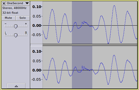

Now switching back to the normal waveform view and you can see that scratchy bit of waveform that is producing the click:
We just need to select a little but tighter to get a selection that is no more than 128 samples:
And now we can apply the “Repair” effect:
And that looks much better.
