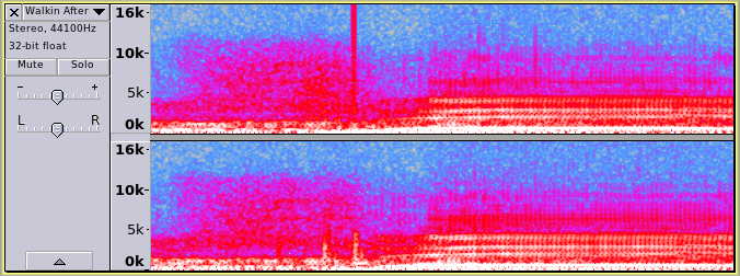

This is a track I’ve been working on recently. You can clearly see a click in the left (upper) channel, indicated by the red vertical line:

At last! Got the little blighters. Using the spectrogram makes life a lot easier :slight_smile:
