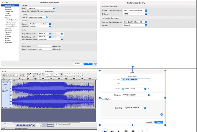

Hey everybody, thank you for the support. I’d like to share some screenshots to see if anyone can spot something I might be missing. From what I’ve seen others write about this set-up, everything seems to be up to par. For what I’m creating, I am not using a microphone (Top Left)
Although I am not trying a new project at the moment, I was also curious whether this quality setting matter. It was defaulted to fastest. This is a feature I do not remember replacing on older versions either. (Top Right)
Here is a screenshot of how a track would appear. Everything appears normal. (Bottom Left
Finally, I am also attempting to plug a stand pair of headphone into the available headphone port on this device. Audacity does not identify the port in use until I back out of Audacity and restart it. Would that have anything to do with what I’m getting in the final Export quality. And, would it be reasonable to change the 16-bit PCM to 32-bit float to match the sample rate I’m already working with through Audacity, or will that not matter in the export phase? (Bottom Right)

The first thing I notice is the amplitude of the tracks, it shows clipped…
If ripped from CD try another track and check its amplitude… Are you ripping to WAV or mp3 try and reduce the amplitude.

Your performance quality settings are OK and should work…
The problem as your screen dump shows looks like something to do with how you generated the file and how it got into Audacity.
Regarding the audio devices on your mac… check the actual device settings and are they all working in other software applications
