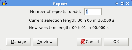

If users are getting confused as has been suggested, then I think only changing to “Number of repeats” and no other changes would if anything be less clear than now.
So I think the text should be “Number of repeats to add” or similar and we don’t add the current selection length, OR if we add the current selection length then “Number of repeats” is OK.
I also thought about adding the current selection length, but it might make the effect “look” more complex than necessary.
I agree that a default of “1” repeat makes what will happen clearer.

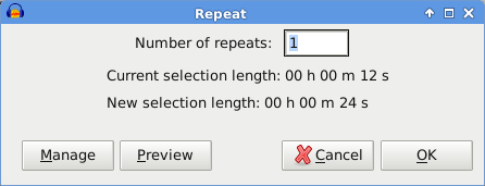

I do like the idea of using the current Selection Toolbar format for the displayed length. If we did that the default format would give us text that looked like:
Number of repeats: [ 1 ]
Current selection length: 00 h 00 m 03.367 s
New selection length: 00 h 00 m 06.734 s
I can only vote one way or the other, so I would vote not to add current selection length on the grounds it adds a lot of extra text versus adding “to add”.
We could cut down the amount of text by putting “Current length:” and “New length:” rather than “Current selection length:” …
However, I don’t think that it looks excessive to include the word “selection”, and it is perhaps a bit clearer.
I’m in favour of including the current length, not only because it clarifies the issue of “new repeats” vs “total repeats”, but because it’s useful to know the selection length when using this effect, and the Selection toolbar may be set to show End time rather than Duration. I like that the interface shows all of the relevant information at a glance.
+1 for that (I like good labelling on the tin, as you know)
and I quite like the idea of seeing the original selection length and the new after-repeat length - and I like the idea of using thus users current format setting from Selection Toolbar.
I think that “to add” is unnecessary verbiage, especially if we show the original length as well as the new length, but I don’t feel strongly about it, so here it is (out of the box settings):
