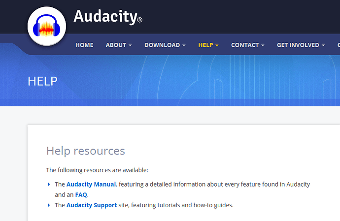

It looks to me, from examining the updated Audacity website on the Help page:
that Muse may be planning to keep a slimmed down manual as a reference book for ever feature, commands, prefs, effects etc. - whilst using the GitBook Audacity Support site as a how-to with tutorial like instructions on how to actually use Audacity. Over time material is likely to be moved from the how-to sections of the manual over to GitHub. That has already happened with some material (in some cases copied word-for-word). The material on FFmpeg installation is an example of this, but there are other tutorials that have been coped into the GitBook, fore example: “Splitting a recording into separate tracks”.
I did have some discussions with Muse a couple of weeks ago (Leo and gguzman) along these lines where my opinion was that it was important to retain at least a detailed reference Manual
a) for users - as some of the prefs, commands and effects can be quite subtle in their usage
b) to effectively act as a spec. for Audacity. Audacity, in the past at least, has never AFAIK had documented and filed written functional specs.
And I did volunteer to help maintaining such a pure reference work on an ongoing basis in my spare time.
BTW I retain the privileges (for now at least) of editor status on the Manual (and Wiki) so I can curate those, but I have not subscribed to Muse’s Gitbook, so the content of that is down to them.
I am somewhat surprised that on the Audacity Website > Help page they have placed the manual above the Audacity Support GitBook.

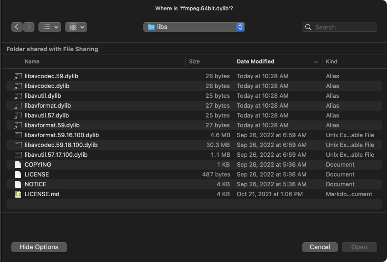

What Mac are you using? Is it Intel or M1?
It appears that the right files are in the right place.
What happens when you go to Libraries Preferences, click the “Locate” button then navigate to the folder where the libraries are installed?
– Bill

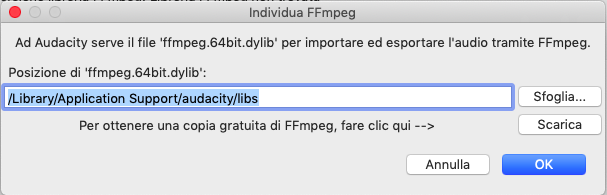

Hi,
I am using an Intel based Mac.
If I go to library preferences and I click on locate I get this window.
Sorry: this is the window that opens if I click “locate”
Something appears to be wrong here. I cleared my “libs” folder, and downloaded and ran the recommended FFmpeg installer. When I started Audacity it automatically detected FFmpeg.
In the “libs” window, can you click on one of the “.dylib” files to select it? Does the “Open” button become active?
If not, click the “Show Options” button at the lower left of the window. Then in the “File type:” drop-down menu, select “All files”.
– Bill
Hi Bill,
firstly thanks a lot for your help.
Just to be sure, I cleared my lib folder too and re-installed with the proper installer.
The files that now are present in the folder are the same you posted, but they were the same also before my re-installation.
Running again Audacity did not lead to the automatic detection of the FFmpeg library.
The option was already set to “all files” and yes, every dylib I select (I have 9, like you) enables the “open” button. Unfortunately if I click OK, for all the files, I always get the message that the required library was not found.
