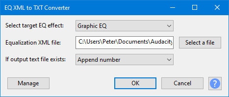

Does the plug-in look like this:
To use the plug-in:
  1. Create a new, empty folder somewhere convenient
  2. Place the “EQ_toolbox_78rpm.xml” file into the new folder
  3. Launch the “EQ XML to TXT Converter” plug-in from Audacity’s “Tools” menu
  4. Select “Graphic EQ” or “Filter Curve EQ” depending on which effect you want to use the curve in.
  5. Click the “Select a file” button
  6. In the file browser that opens, locate and select the “EQ_toolbox_78rpm.xml” file
  7. Click the OK button
There should then be a message when the plug-in has run. What does the message say?

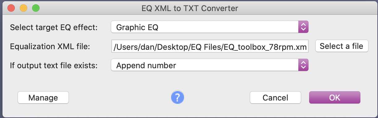

Here is the dialog with the file selected.

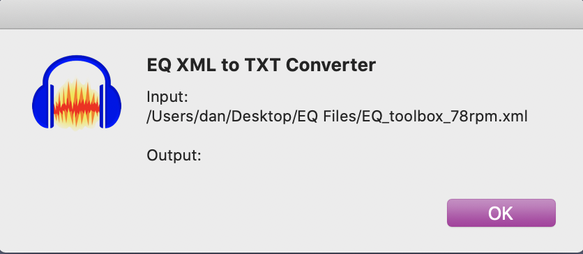

Here is the results dialog.
And, nothing it written.
