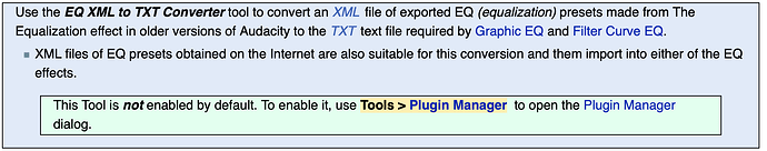

The manual says:

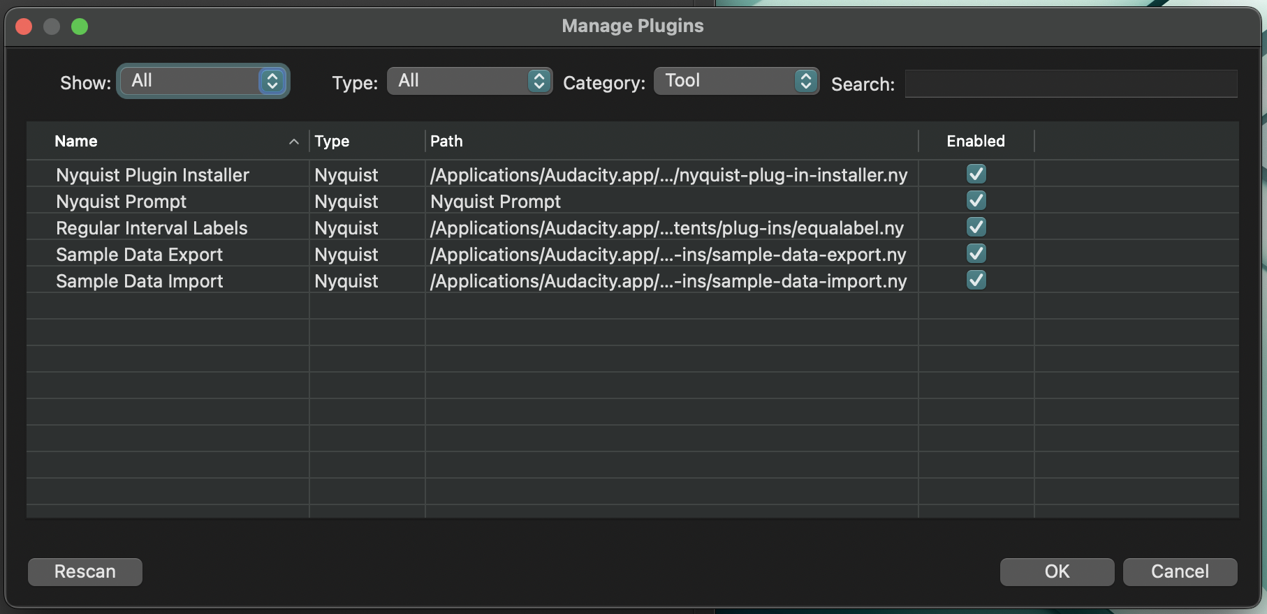

So I open the Plugin Manager to enable the tool, but I don’t see it.
What am I missing or doing wrong?

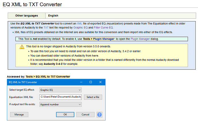

was about to put an editornote on the page for that tool to deal with this later - but realized that it was just as easy to implement option b) above.
So now the alpha manual for the upcoming 3.6.0 version of Audacity reads like this:

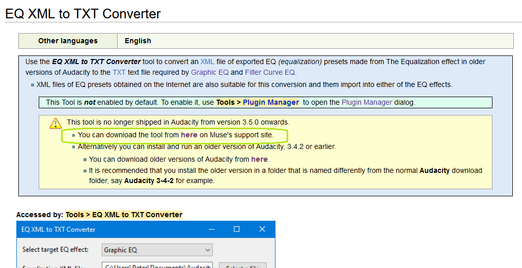

So I have firther amended that page in the 3.6 alpha manual, which now reads:
