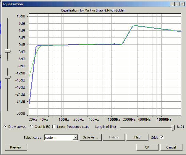

I applied the Anti-RoomBoom first to get rid of that sonic boom from the walls of the hall, then Effect > Leveler to punch up the presence and the Anti-Muffle (second curve) to punch up the drums and lead guitar.
If any of those filters or effects goes into clipping, Analyze > Find Clipping, View > Show Clipping. Effect > Amplify and bring down the overall level.
You can make it less bright by bringing down the overall Anti-Muffle curve. Remembering that your speakers have a lot to do with how you apply corrections. The bass guitar in the original clip is enough to give me a nosebleed here at home.

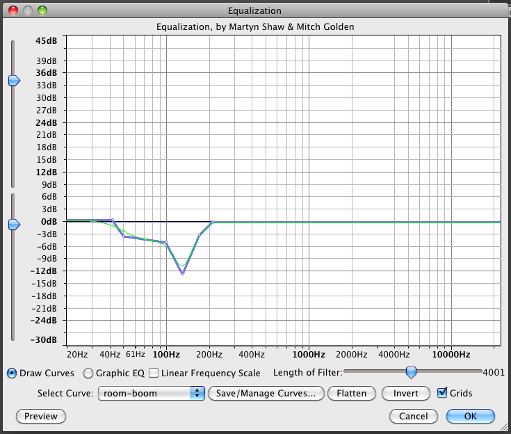

Can you post the roomBoom XML file? I don’t have that one.
You don’t have either one. They were both custom drawn for your show.

room-boom.xml (388 Bytes)
anti-muffle.xml (290 Bytes)
I did Analyze > Plot Spectrum and saw that the bass guitar and probably the kick drum were “ringing” in the room. They were much too loud in comparison to the rest of the show. That happens in certain clubs and it makes it almost impossible to record a show from the audience. You can’t hear the band in real life, either, but that’s less of a problem when you’re spilling beer on yourself. One bass note in particular was pretty awful and that’s the single downward spike.
The rest of the spectrum told me that the overall room had a flannel sheet muffling effect on the show, so that’s the muffle filter to get rid of that.
You can apply as many filters as you like. I did it like that because sometimes you can’t even hear some of the problems because the worst ones are so bad. The leveler gives you a dense, harsh, forward, fuzz-guitar sound. Try the show without it, or try applying it at a higher setting.

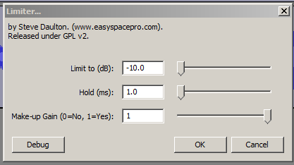

  2. Dynamic range Compression using Steve’s limiter

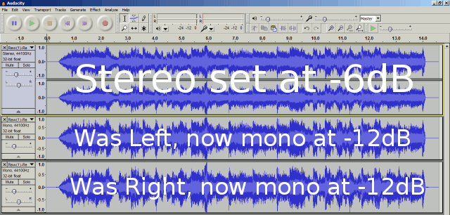

  3. Adjust stereo image by mixing in mono duplicates of the stereo track, (by now EQed and compressed) …

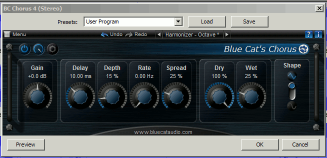

  1. Apply chorus (10ms delay) to the stereo track only …
