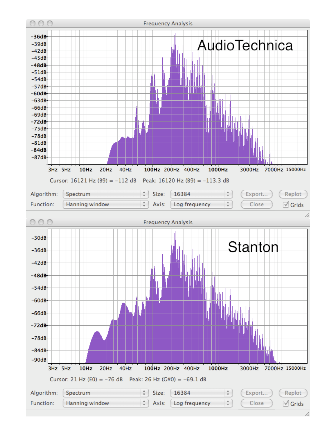

it’s been a few months, but this thread comes close to a quesiton i’m pursuing, re: the best phono cartridge for my LP importing.
[Background details: this is from a Stanton turntable with digital SPDIF out, coming through an M-audio firewire 410 box. the source is ~ 2 minutes of solo classical guitar. i’ve also applied the ~hi-pass equalization filter recommended by Steve, above, in both cases.]
below are the (log frequency analysis) plots for an AudioTechnica cartridge and a Stanton cartridge. the Stanton is noticably (about 7 db) louder than the AT. i’m curious about the differences in these response curves. Eg, the Stanton has a mode ~ 15 Hz entirely below anything produced by the AT?!
should i care?! are there general characteristics of “good” response curves? have any others evaluated cartridges this way?
Which sounds better?
ah. my opinion is confounded by hearing the Stanton with a different pair of speakers than i was used to with the AT cartridge, and now also by applying your equalization filter. (the last time i was on this quest for perfect sound, i was a teenager buying my first stereo. i thought i’d learned my lesson, but i’m afraid Audacity has made me a monster again!)
but this all just made me curious. i saw here that waxcylinder
was apparently able to do much better, and i was wondering if anyone was doing component profiling tests, ala the streaming alternatives he mentions.
