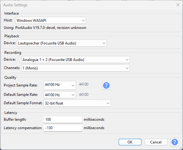

As an initial example, For my device, a 2 input Focusrite Solo, when recording to mono I never can get above -6dB

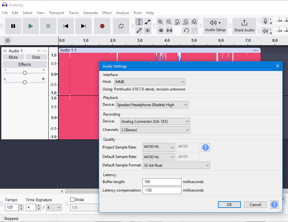

Testing on W10 and Audacity 3.7.1 with my Edirol UA-1EX

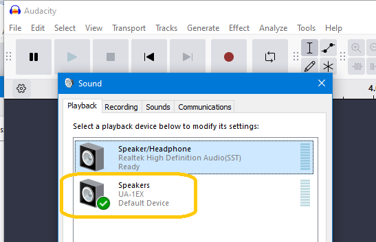

1) Plugging in the UA-1EX
When I first plug in my UA-1EX not only is it invisible to Audacity it is also invisible to Windows (Disabled by default)
Even more curious the UA-1EX IS set to be enabled AND default - which is less than ideal as there is no output device connected to it.

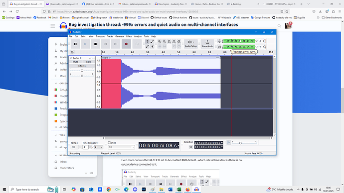

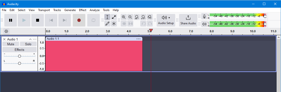

2. Initial Recording - default MME host
So after I enable the UA-1EX for recording and with the output switched back to my onboard soundcard and following a Rescan Audio Devices, I readily get clipping
Note that I can mitigate the clipping by turning down the mic slider in Audacity (I recall from many postings that this is/was not always possible for users of USB cards)
3) Audacity Mic slider versus gain control on the UA-1EX

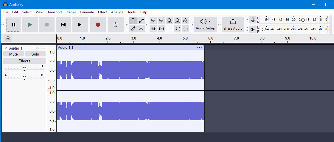

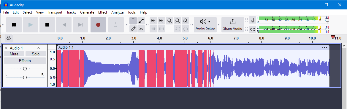

I can also mitigate the clipping even with the Audacity mic slider turned up to full - but I observe that I get different results.
a) UA-1EX gain control at max and Audacity mic slider choked back
with this I get what looks like a strictly limited waveform
b) Audacity mic slider set to max and UA-1EX choked back
here I see an unlimited, unrestrained, waveform
Not all USB cards have a gain control
(the Edirol has two, input and output, that’s one of the reasons I bought that device)

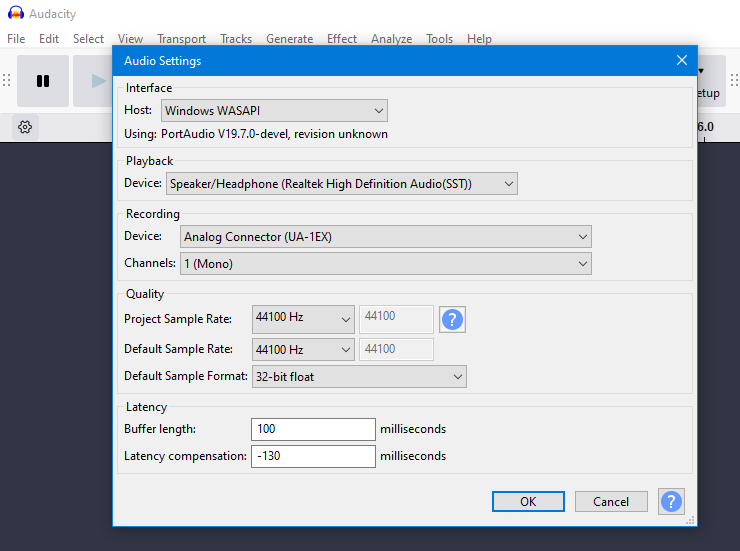

4) WASAPI and mono
As requested by @LWinterberg in his step5 I switched to WASAPI and mono
And with this I still readily get clipping with both the UA-1EX and Audacity mic input slider both set to max
And similarly with WASAPI I can control the signal to mitigate the clipping with either the Audacity mic slider or the UA-1EX gain control.
