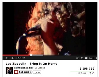

It does sound like he is singing into a harmonica mic at the start of the track (a bit muffled and too quiet in parts), but the track abruptly changes at 1m44s where I think a different mic (and definitely different reverb setting) is used.
Update [courtesy of YouTube’s slightly-creepy unsolicited “recommeded for you” video suggestions ]
Looks like two different mics are used , one for harmonica one for vocal …
